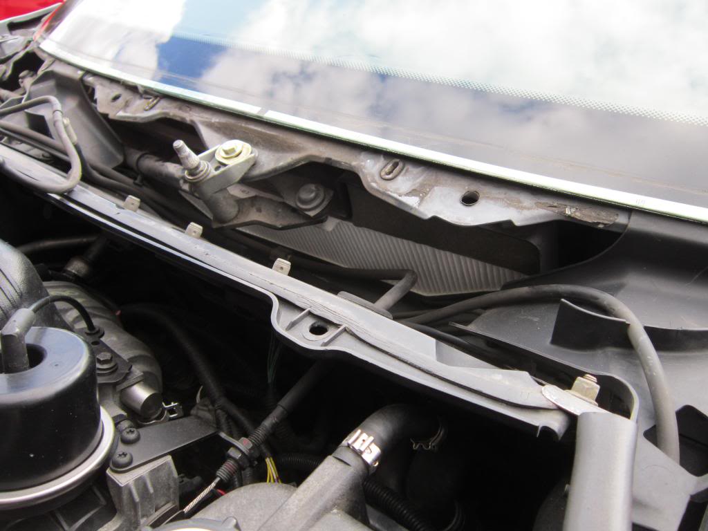

Remove the wipers (you'll need a little tool to "pop" the wipers off their spindle), remove the plastic plenum panel, and you'll see where the filter can go.
This might help:
Attached Thumbnails cabin filter-img_1502_zps4baac776.jpg   cabin filter-img_1501_zpsa363620e.jpg

Knowing what you're looking for can help. Here's the extract from the Parts Catalogue showing the housing and filter:
From previous threads about the pollen filter, those who have one fitted have often found it does more the restrict air flow to the AC than provide effective filtration as it can easily get blocked.
