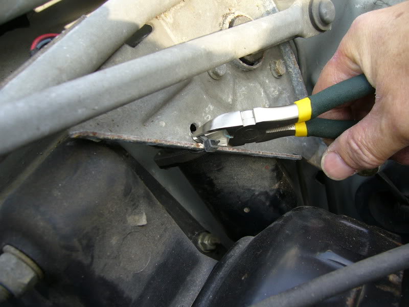

Using a pointed impliment (I am over 16 years old .... in body anyway) remove the 4 covers which allow access to the screws.

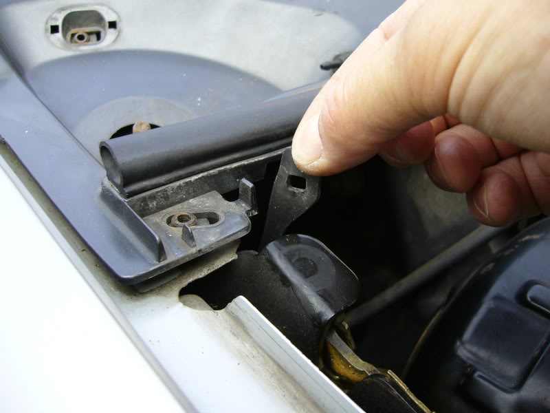

Using the same tool, remove the two nut covers on the wiper arms and also pull off the water feed pipes. The pipes were a bit tight but came off without too much grief.

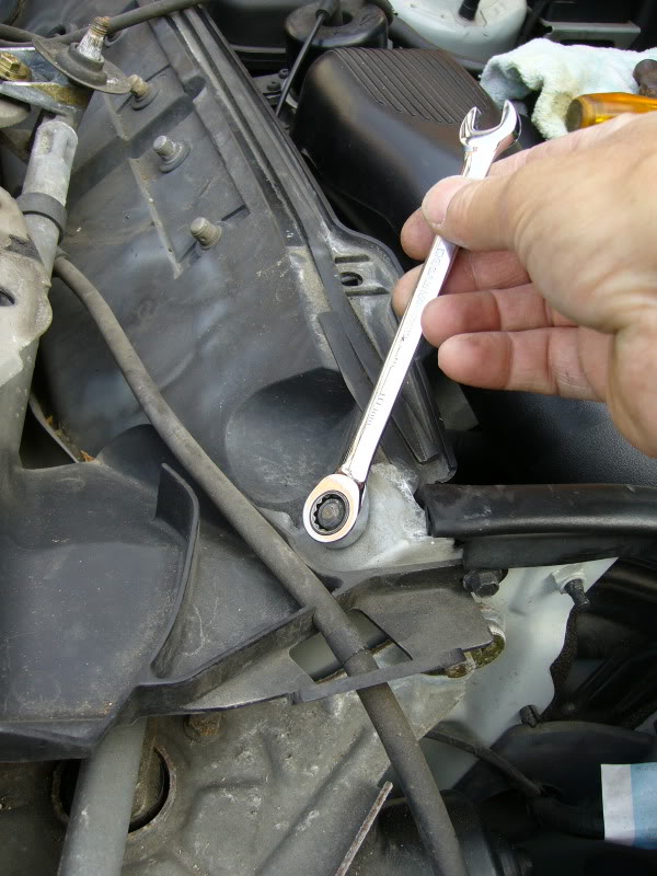

Remove all 8 self tapping screws and the two plastic expanding fixings at the front of the scuttle plate. Also, there are 2 rubber straps which have to be un-clipped. These hold the scuttle drain pipes in place.

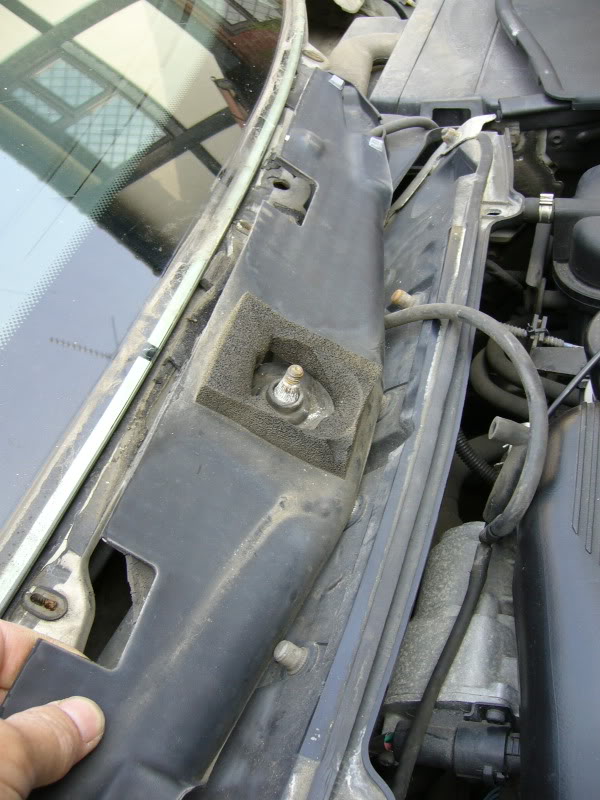

Lift off the scuttle plate and turn it over to reveal the main water supply pipe, again, it comes off quite easy. Beware .... When turning over the scuttle, watch out for the circular guides the self tappers pass through. They look to be secure but do drop off, so it's best to remove all of them and put to one side.
** You can see one of the circular guides in the picture directly above**. It's sitting underneath the slot.

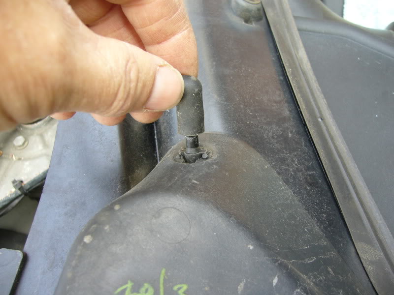

Next, remove the plate which protects the cabin air intake from water ingress. It has to be gently peeled off and the foam rubber passing over the circular plastic wiper disc. Once you see this, you'll understand immediatly what needs to be done. Also a couple of small hard rubber pieces will be sitting in the foam rubber. What these are for, I have no idea, but they will be there.

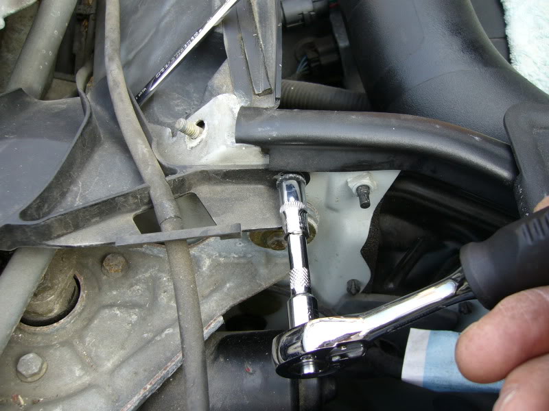

Undo the 3 securing bolts, pull off the throttle cable clip which holds in place against the wiper linkage. Then slightly lift the assembly and reach underneath and remove the electrical connector. The metal bar has to be pushed in to release the holding tangs. And finally cut the tywrap which secures the electrical cable. The whole assembly can now be carefully lifted out.

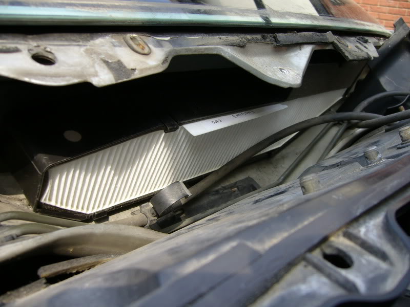

The pollen filter assembly consistes of 3 main components. The frame, filter and 2 "self tapping" 6mm bolts (probably used to cut their way through the paint in the threads).
After a lot of cursing and swearing ....... "Oh why did I start this 'kin project" It dawned on me that I was trying to put the dammed frame in the wrong round . Once it was rotated the correct way, in it went ........ Piece of cake.
Use the picture as reference to which way round the frame fits.
