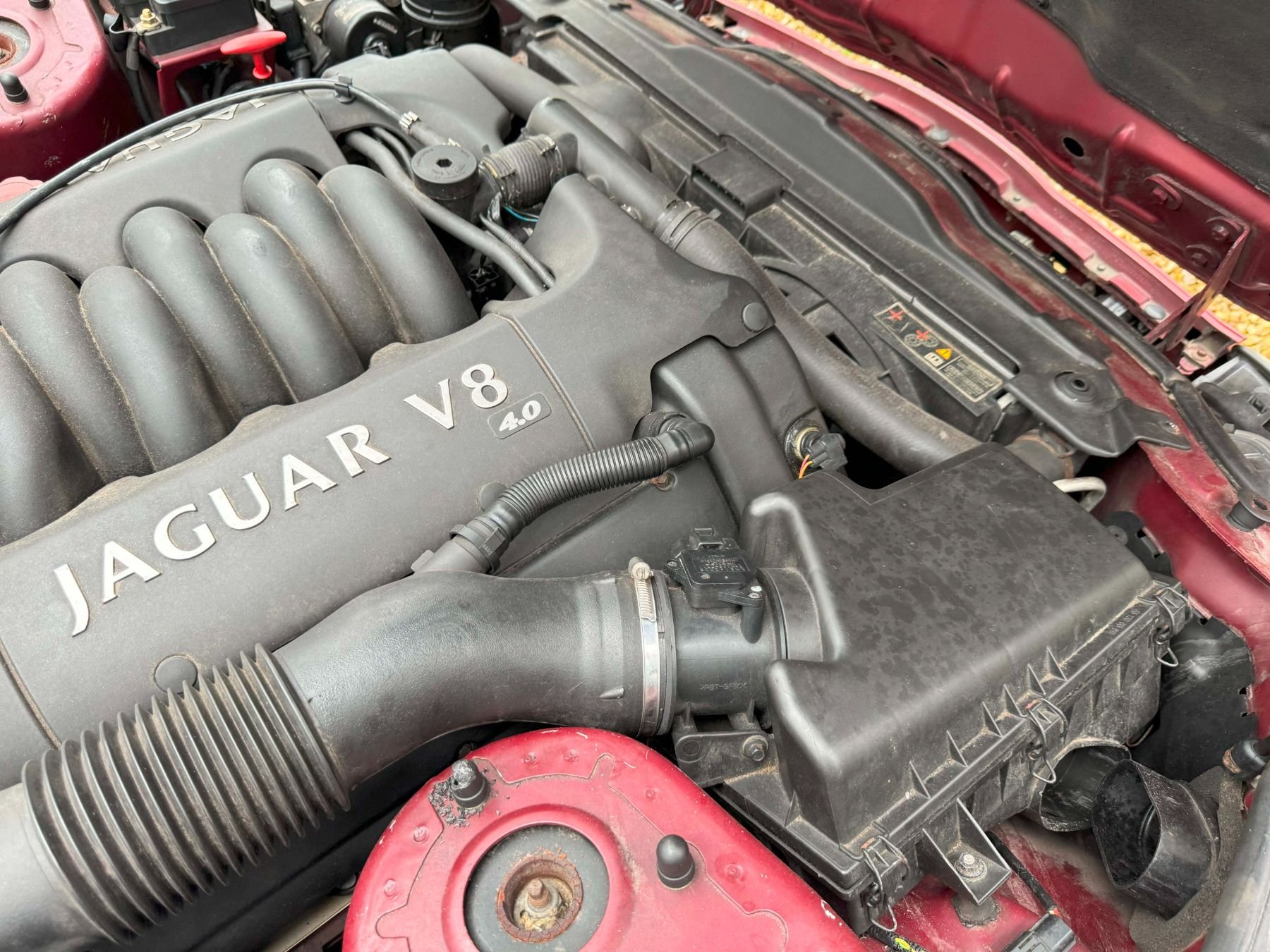

Ah ..... you didn't mention the missing engine covers in your original post which I first replied to, and in your clarification to Michael you referred to "cam covers" which is the same part you refer to in your thread title and in your post above and which you have with you.
You can work it out from these two photos.

Thanks. That helped. Looks like a previous mechanic used some extra "tall" bolts in random places rather than the correct ones so I was able to identify where they go (by the plugs in yours).
Almost forgot the dipstick gets a tall one too, luckily figured that out in a test fit.
