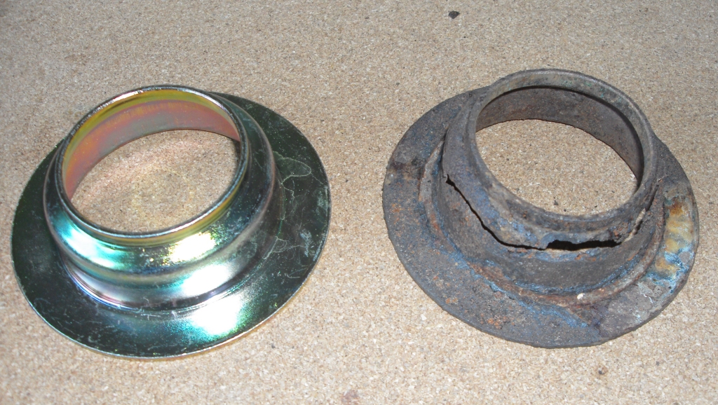

The spring sits on this sort-of "cup". I suspect yours will not be nearly rusted away like mine was !!
Photo shows old & replacement. There's also a thin rubber packing washer, and a plastic seat that, if original, is shaped to locate the bottom end of the spring.
