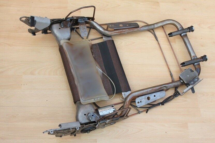

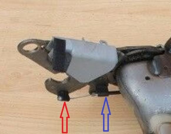

Hi, it's difficult to comment without a picture. There is a cable to both left and right hinges of the seat. See pics below.
The 'Press Stud' that you explain, I think it is the reverse side of one of these black items shown. Is this right? Do you know if it is the lower (Red arrow) or Upper (Blue arrow)?

Hi PKWise,
Thanks for those pictures. The "press stud" is the reverse of the item at your red arrow. I can reconnect it, it will work once or twice and then pop out again!

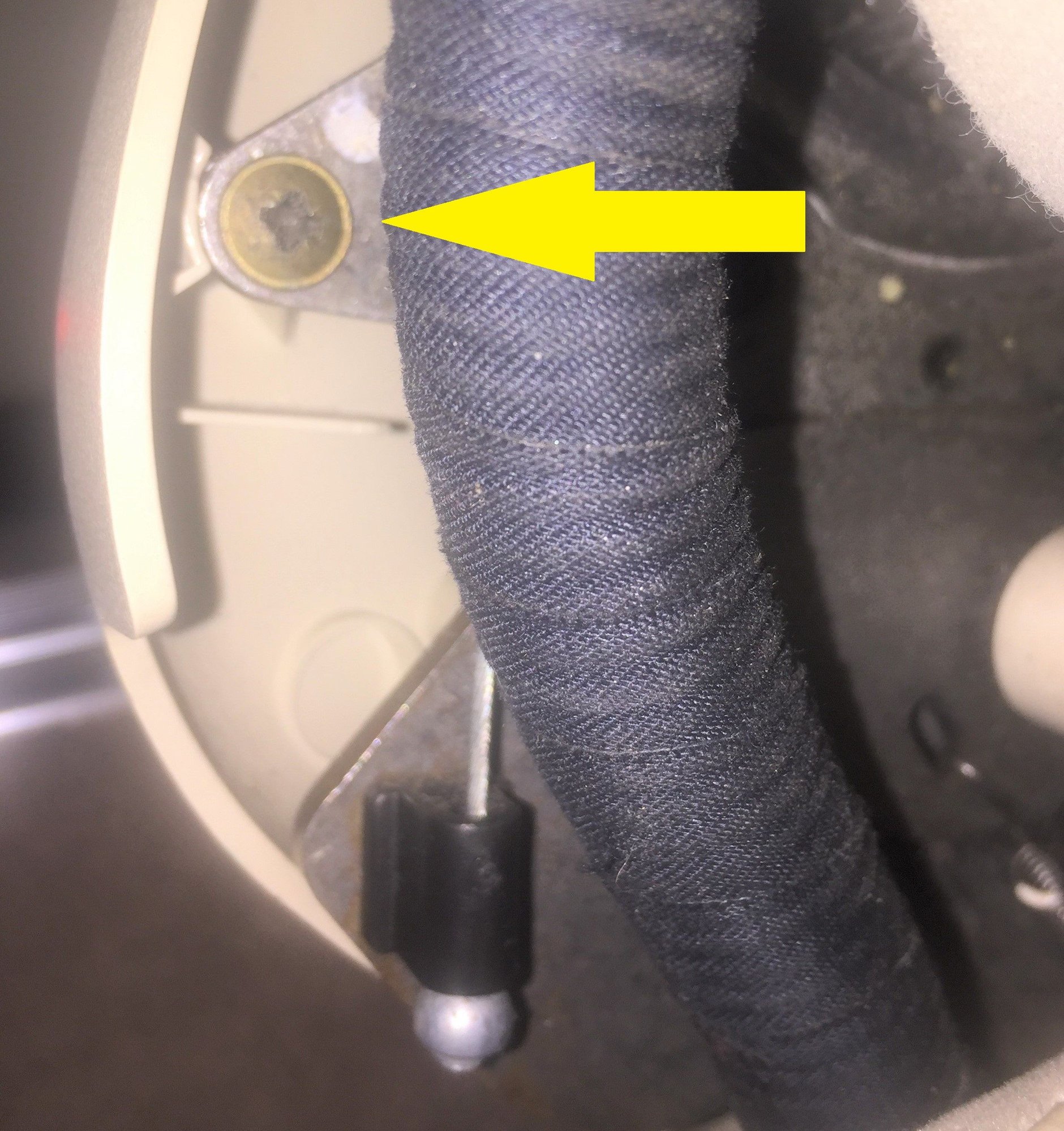

1. First, you will need to remove the outer hinge cover. Be careful to remove the one screw on the inside (yellow arrow), then pull off -there are some inner clips around the edges.

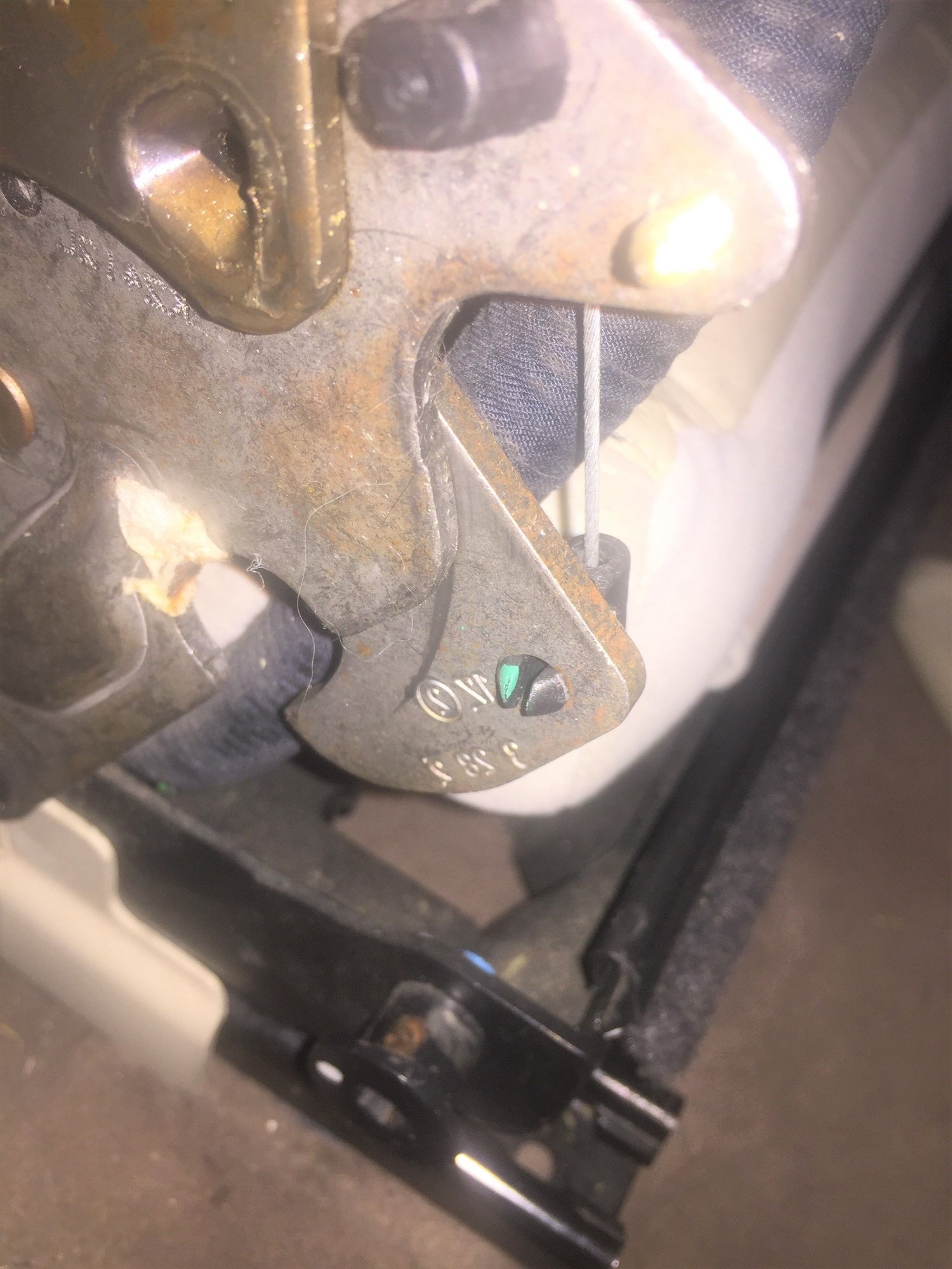

2. This will reveal the Press Stud in question (second image) - which I presume has a damaged clip end-form (green paint).

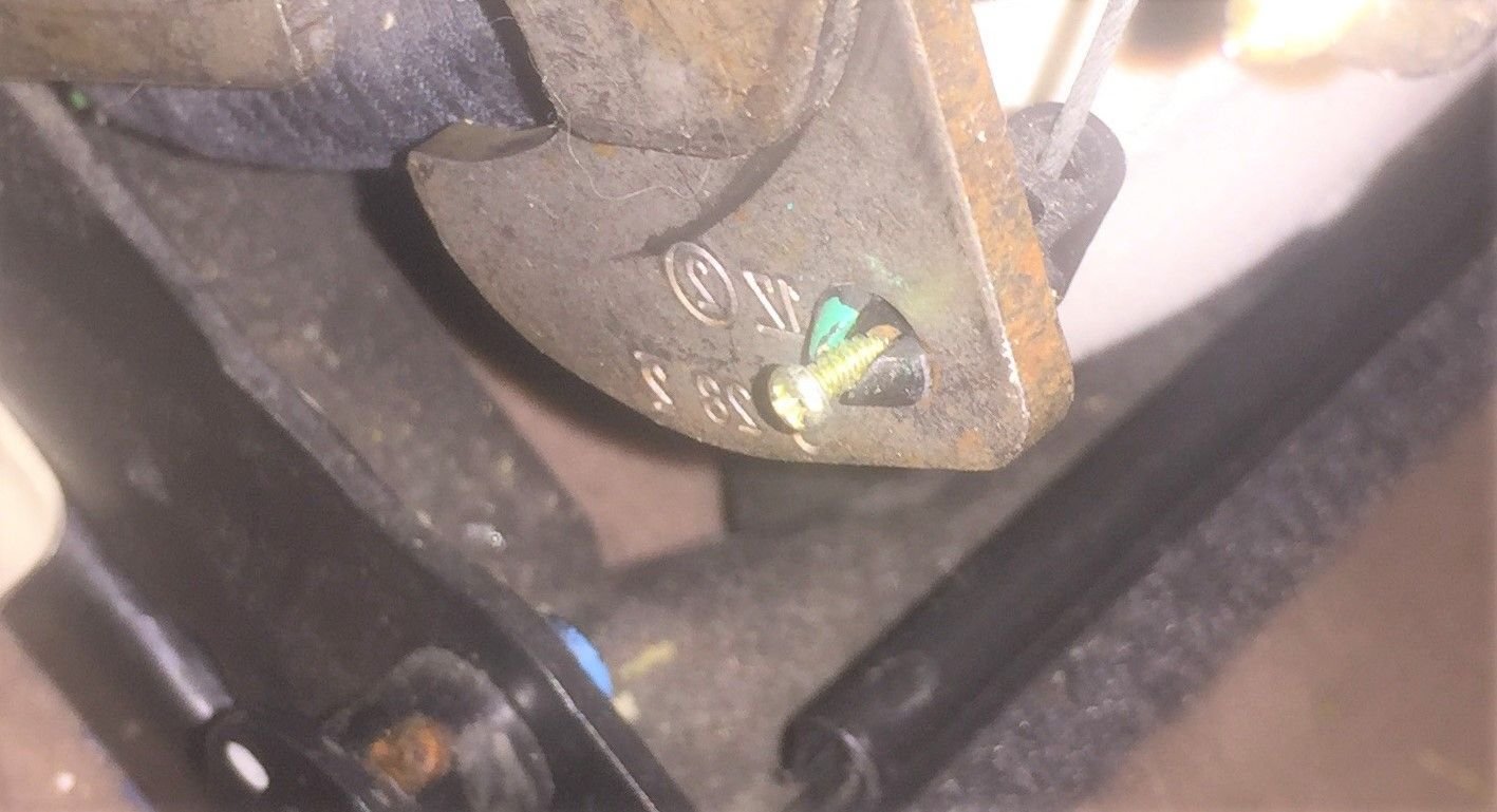

3. My idea is to fit a small self-taping screw between the leaves of the clip (as demonstrated in centre of third image). Perhaps include a washer as well. Screw size unsure but only 8mm long max. Don't over-tighten as it will damage the clip.
This is just an idea that I would do in the same circumstances. I can't guarantee the life but I've seen this done successfully in other applications.

Hi PKWise,
I have done something along the lines of what you suggested and for now it's holding! Thanks so much for the good suggestion.
