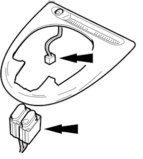

Is the ASL operating and limiting your top speed regardless of throttle position or is it just the tell tale light on permanently?
If it is permanently engaged, I'd suspect the switch has failed in the ON position. Disconnecting the multiplug should verify this. To access this, the transmission selector veneer panel has to be removed.
Very easy on the later models with four torx screws in the aluminium surround. RTemove the four screws and lift the aluminium surround off. The veneer panel then lifts out with the ASL and Sport switches attached.
