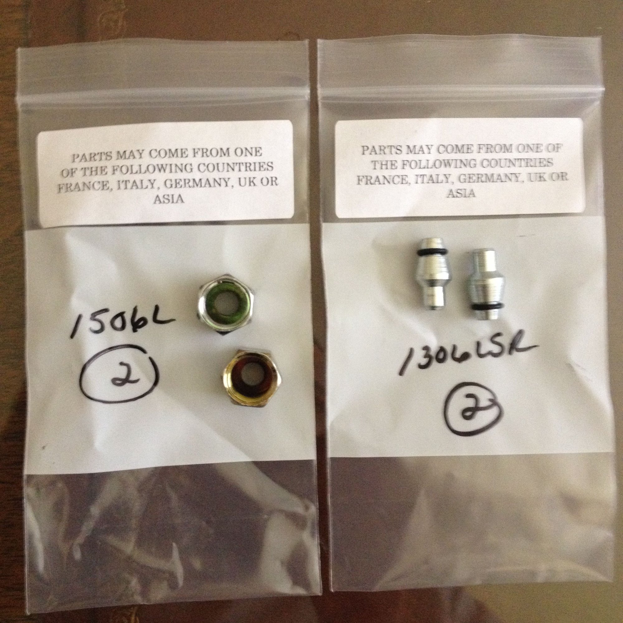

To cap the latch hoses at the pump, I bought qty 2 1506L compression nuts, and qty 2 1306LSR blanking plugs with o-rings.
This solves my dilemma, and converts the convertible top to a manual latch system.

Received the hydraulic line caps for the latch connections at the pump this morning. Picture attached. Larry at Malone is the best. Removed the original latch hydraulic lines and inserted them into an open water bottle, neatly tucked in the cavity just ahead of the CD/Navigation rack. With a hex wrench to manually open/close the latch, everything works like a charm, and for $25, which is considerable less than $2000. Thanks again to everyone for the solution, direction to Larry, and the prior experience. Very respectfully, Bob G.

Oops. Here is the photo of the parts from Larry at Malone.
