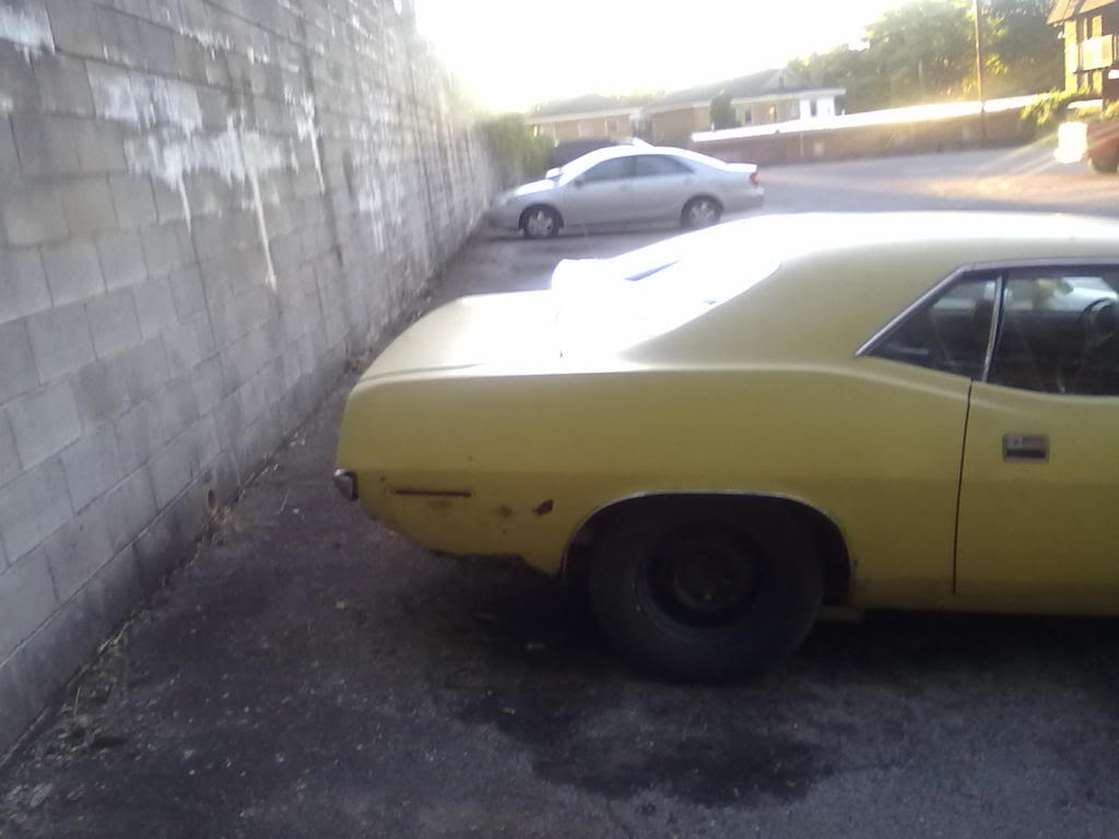

I make a innocent mistake from the drop down and now I am being accused of lieing, by someone who jumps into my thread and just wants to cause problems.
To settle this real quick, here is a pic and for anyone that wants, I will show them my bill of sale, now Kevin go back into your little world and leave me alone, that is my old vette beside the CUDA.
