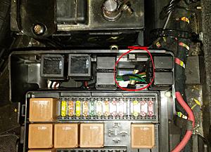

Yesterday my check engine light on my 2002 4.0 XK8 came on. Run a scan and came up with the code P1646. After researching, the code tell me a defective fuel pump 2 relay. Later models supposed to be a O2 sensor. Went to check the relay and it seems to have vanished. There is a missing slot where it is supposed to be. Cannot see any empty connectors either. Anyone have any idea where it might have vacated to? I have attached 2 pics as to where it is supposed to be.

The XK8 only has the one pump the R has a second one.
