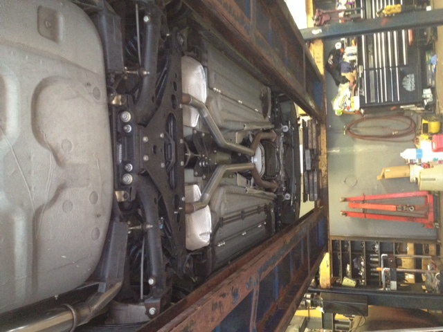

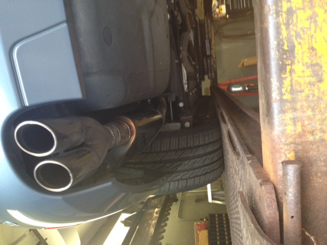

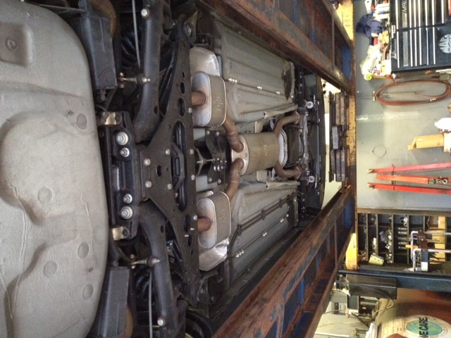

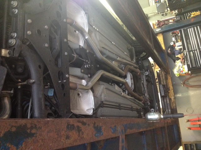

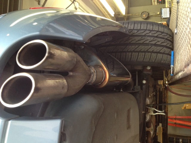

2005 Jaguar XKR – a beautiful grand touring coupe without a proper exhaust note, or any exhaust note for that matter. Yesterday I certainly took care of that problem. For the past month I have researched various exhaust options for the XK8/R and I have learned several important things:
1. One can spend a considerable amount of $ to buy a name brand exhaust system and still not achieve the desirable exhaust note.
2. YouTube videos showing dozens of clips with various exhaust systems and configurations are deceiving, as I have learned through my own experience, when I posted my video clip. The sound coming through YouTube is usually less dramatic and not as intense as when you hear it in person. The exhaust note that sounds loud in a YouTube video is actually considerably louder in person. This may possibly lead one to pick a system based on a YouTube video, only to find out that the actual install does not sound exactly the same when witnessed in person.
3. What sounds great to one person may sound not grand to another. Pouring over countless forum threads on the topic is fun, but following someone else’s steps may lead to disappointment, as people’s taste varies from one person to another (duh ).
4. Jaguar XK8 is so rare that not many companies want to design for our cars and the one’s that do, naturally require a hefty premium for their R&D effort.
I spoke to several muffler shops in the New York Metro area and learned that while I have but a few options to choose from, all of them are on the expensive side. So I decided to proceed with a different approach – one of trial and error. I found a shop that was willing to experiment with the exhaust system by removing OEM muffler components section by section in order to understand which mufflers to leave and which to remove or replace. We started at the back by removing the post-axle set of mufflers. That really did not change the exhaust note much. There was a tiny bit more noise coming out of the back pipes, but no desired growl. We then removed the small boxes right before the axle only to find out that they have no influence on the sound what so ever. With only the big center muffler left, we knew that we could not take it out without compensating for it with something else or the would be way too much growl. The shop mechanic recommended that I install a set of Magnaflow High Performance Street mufflers after the axle, but I really wanted Borla boxes. A while back I had a 911 with an after market Borla system and it was incredible. It turns out that Borla does not make rear mufflers for 2003-2006 XKRs . The mechanic convinced me that Magnaflows would work perfectly and I would get the deep growl that I am looking for in the exhaust note. Plus, he said, the Magnaflows cost a small fraction of what Borla, Arden and Mina charge. I reluctantly agreed. I was extremely disappointed, when after installing the Magnaflow set of rear boxes, the car became even quieter than before. That meant one thing – the large OEM center muffler had to go. After it was removed, Magnaflow became the only mufflers left on the car. After turning the ignition on, the car came to life. The exhaust note is now a deep burble at idle. As I apply the throttle, the cat roars like an angry beast that it was meant to be. It sounds more like an Aston Martin now than it does like an XK8 and I truly love it. Within a week or two, I will continue with the experiment, by adding a Magnaflow X-Pipe.
For those who are interested, I’m attaching some pictures of before/during/after, as well as a video clip of the final configuration. As I mentioned before, the sound on the clip is less intense than in person and the occasional crackling that you hear, is so deliciously sweet sounding in person, but more of a popping noise in the video. If anyone has questions or comments, be my guest.
Here is the video link:

That is orgasmic. I would love to hear it in person. So how much did it cost you? Where is the cat? Will that affect the car's ability to pass state inspections?
How different do you think the sound would be in a N/A 4.0 XK8?
Old Oct 12, 2013 | 03:15 PM
DevSpider's Avatar
Joined: Feb 2013
Posts: 314
Likes: 63
From: Long Island, NY
Orgasmic is a good word for this exhaust note. You can hear it in person if you're in NYC area. The total cost was under $700.00 and most of the cost was due to labor as we were experimenting with different set-ups and this was time consuming and required extensive pipe customization (bending and cutting). The cat is in place. I left it stock, so the state inspection should not be an issue.
I have to say, that at first the ride seemed loud, but after one day of driving, not only am I used to it, but I also rev the engine more frequently to hear the growl. Don't get it done if you want to stay incognito - people will hear you coming and going
