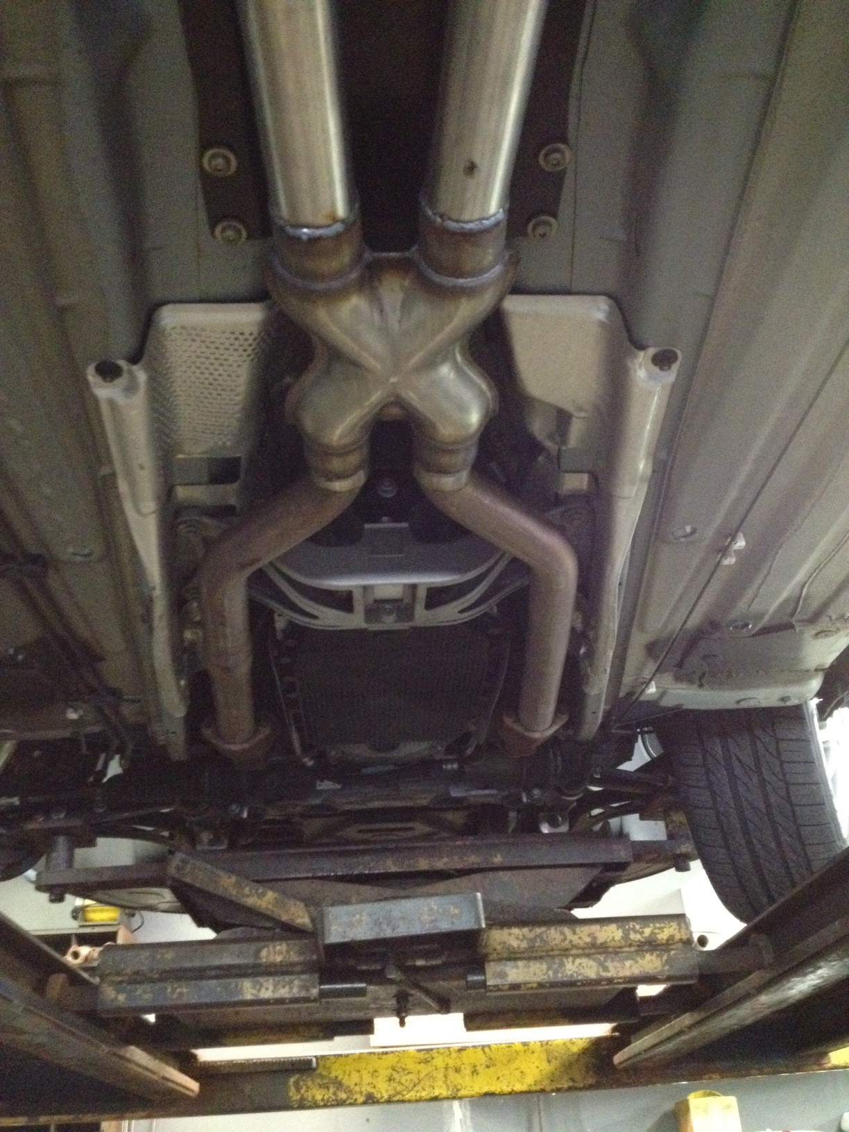

Default Update: X-Pipe Install
TGIF... Just returned from the mechanic. Alas, the X-Pipe is now installed on my car. It's bittersweet - the rawness of the exhaust note is gone; replaced by more polished, more tuned, or, I should say restrained sound of a true luxury GT. My impulsive side wants the Xpipe to become an X-memory, as I got quite accustomed to ferociousness of the exhaust sound sans the Xpipe. My neighbors, passers-by and pedestrians can now carry on the monotony of their business, commute - without the distraction of knowing that a Jaguar XKR has forced itself into their space. Ok, ok… it’s actually not as bad as I am making it sound. Where the cat lost its mojo in the G R O W L, it has made up in power. The XKR is no slouch to begin with. Now it “exhales” more evenly and sprints beyond the freeway legal speed with more authority; less aggression. It still makes all the right sounds, just less of them. Am I keeping the X-pipe? An honest answer is - I don’t know just yet. I will give it a week or two to see if I yearn for the sound of an untamed animal or become content with the car’s new, softer side.
Below is a Pic of the X-Pipe installed - It's amazing that a little hollow metal box completely alters the sound of the exhaust.
Attached Thumbnails The CAT sounds angry - pics and video-2005-jag-xkr-xpipe-install.jpg
