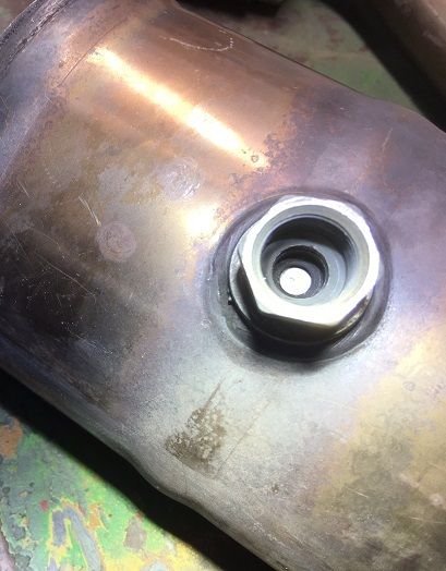

Yesterday, I pulled the bank2 cat off of my car. Happy to say that it came off without anything stripping or breaking. The day before, I decided to crack all of the nuts between the cat and the exhaust manifold and then shot some WD40 over each nut. I believe this soaked in overnight and facilitated an easy removal. Only needed a deep well 13mm socket and a pair of wobble extensions (short, long). Made sure to keep the socket tight and straight on each nut and gingerly got each one off.
Although I was suspect, I had seen a vid on YT that showed someone getting one of the studs out of the cat using the torx head on the stud. I can say 100% that for my rust free CA car, this did not work. Almost immediately, I snapped the head off of the stud - so defintely be diligent on getting a socket on the nut to remove the cat - not the torx head on the stud.
I had to do this as the used cats I purchased were missing one of the M8 studs each and one of them had a cut M10 stud. Once I had my old cat out, I had access to the studs I needed and using heat and double-nutting on the stud + a little hot WD40, I managed to get the studs I needed without damaging any of them. I am going to reuse the O2 sensors for now as they were reading fine on my software. If I run into issues, I won't have an issue replacing them with new if that is what is necessary.
Today, I am moutning up the replacement cat on bank2 and then I will know 100% that it was the issue and fingers crossed - the initial problem will be resolved. If that all goes well, I will then proceed to replace the bank1 cat as I have a pair. I am holding off on that until it is proven to me that these cats work on my car. Since bank1 is more fiddly to get access to, I consider it a time saver until the repair is verified.
I did have a thorough look at the old vs replacement cat last night. I looked into each cat on the manifold end and did notice a difference between the two. The replacement has clearly defined passages in the media of the cat and the old one that I removed has what is obvious collapse of media. So, this cat doesn't appear to be a candidate to fix unfortunately. I thought I would see stable - but blocked media but it defintely looks collapsed or eroded. Whichever descriptor is more accurate. If I find the time post install, I am going to take the angle grinder and cut the top off of the old cat to clearly show how they collapse when they go bad. I tried taking a photo but it is so deep and subtle through the camera lens, it is very difficutt to have it show up. Cutting the top off the old one will make it easy to see.

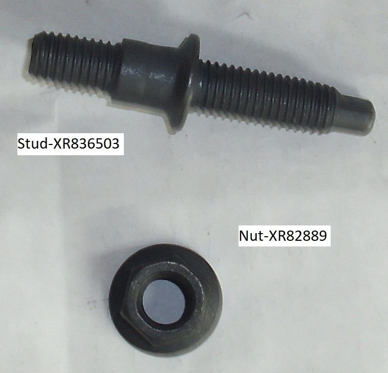

Very good point about removing the stud! I also have a rust free southern car and the studs did take heat and time and spraying penetrate to get them moving. Yes forget removing the stud with the external fitting on the stud! Mine was not Torx but had flats on two sides of the stud for a set of pliers.Use the old fashion double nut method.
Here is the stud and nut I used. I had to order them from Jaguar. At first I thought these should be just common exhaust studs. But after buying several from my local parts store they all were different in one or more ways. Note this was for my 2014 with the 5.0L so not sure how many cars used this stud. Check it with a jaguar dealer parts site before ordering.

Couple of updates.
- Ok, I screwed myself slightly with the purchase of these 2 cats. Although the bank2 cat physically goes on without any issues, the bank1 cat is of no use to these cars as it lacks the connection for the EGR pipe. The good news is that it is the bank2 cat that is causing the issues so in the end, I probably did not need the other one although it would have been nice to mount them both as a set. I was in a panic when I saw the listing and literally took 10 minutes to research before hitting the buy it now button. Someone out there will need a low mileage bank1 cat for a 2003-2006 XKR, so I am not overly concerned about getting some funds back for that.
- Car is back on the ground and I did do some testing yesterday. I still have the 2 monitors not reset. The evap and the comprehensive but I suspect that I need to get her out for a good drive today to see if those monitors finally reset. As I looked at my SDD software live data, I still see a difference in the display of bank1, O2 data vs bank2. THat led me down the rabbit hole last night in understanding more completely what I am looking at and what it means, when also including fuel trims. I know I have only ever changed one O2 sensor on the car and that was on bank1 so the sensors on bank2 are pretty old. Not saying there is anything wrong with them at the moment as they ARE both active. It is just that they might be very tired and that may be the reason for a variation on the results in SDD. Heading to the car here shortly to retest a bunch of things to make some verifications and update my understanding.
- For those that have swapped out O2 sensors on these model years, what brand os sensor did you choose? If I find it necessary, I would like to pick up at least 1 sensor - even if just to do some comparison work on the readings I am currently getting. What I have learned that is super helpful is the differences in how the wideband sensors work vs narrowband and how they correlate to the fuel trims too. I waded through quite a few unhelpful videos but did find a couple that corresponded to the setup on these cars. Will post my results later today for those that may need to understand things better. Fingers crossed.
