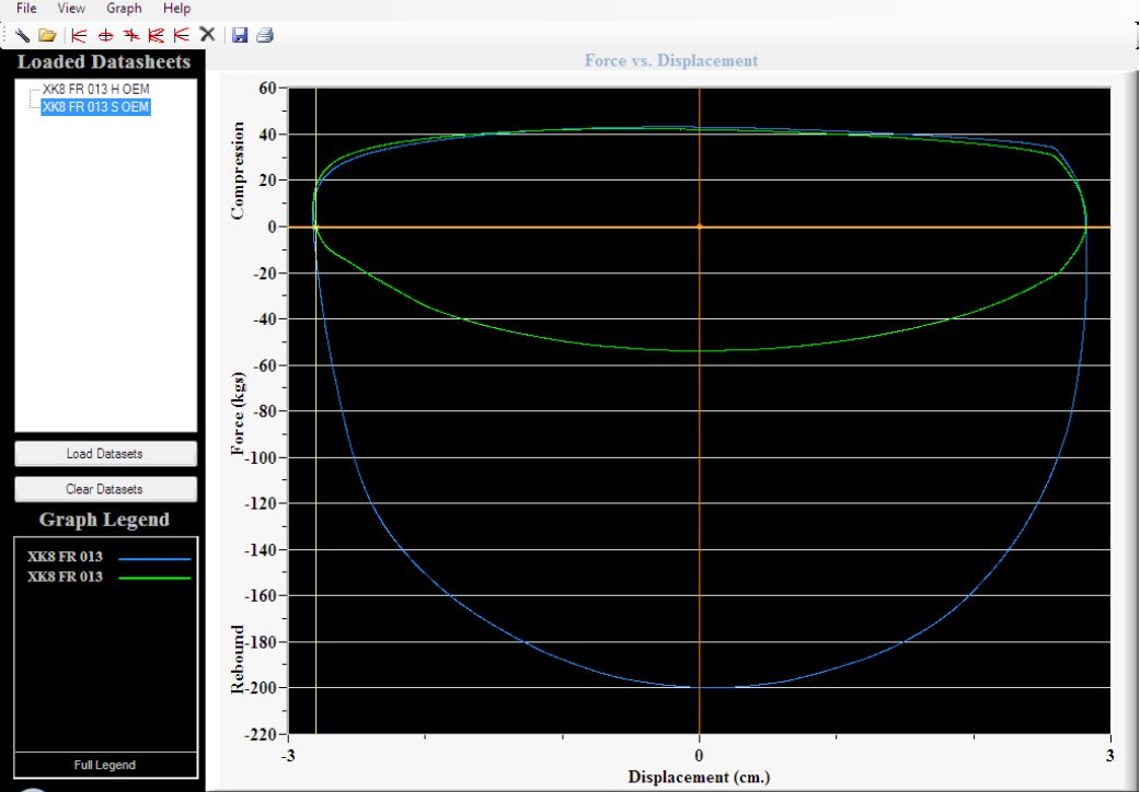

Maybe the cats shocks are a bit stiffer than stock shocks, as they have the ability to switch to a soft setting when required (but only on the rebound!). If you want to know you need to have a dyno, ie performance graph of the stock shock. I have posted earlier one for the cats ones (in stiff and soft mode), then you can compare on paper.

Wouldn't recommend to set the shocks to soft, I would imagine that it would be way to bouncy.
Attached is a dyno of the cats shock in soft/hard setting, and you will find that normal non-adjustable shocks are more like the stiff setting.
