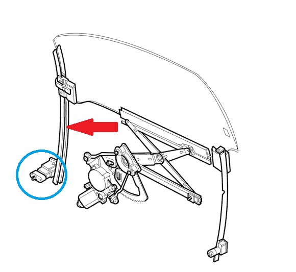

2006 XK8, 95000 miles, second owner. Noticed of late the drivers window raises & lowers slower than the passanger side window. Is this the harbinger of failure? Time diferance is about a second.

As I've found when working on door glasses, it takes a surprising effort to raise a door glass. If the Guide Rail (arrowed in red) is dirty, this can increases the resistance considerably and may explain why your driver's door is slower.
There is adjustment on the Guide Rail (circled in blue). These have been known to work loose.
