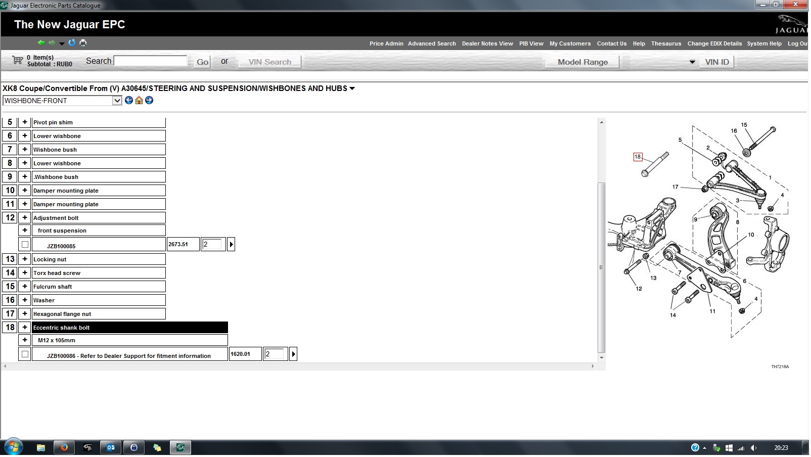

The front camber is not adjusted with shims, shims are used to adjust the castor.
Your car may (or can be retrofitted) have eccentric bolts on the lower wishbone which will allow the camber to be adjusted.

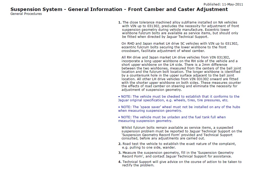

Even the later edition of the Workshop Manual is not particularly helpful:
It appears Jaguar don't expect their dealers to tackle suspension alignment without direct assistance from Technical Support.
Given that adjustment is by means of an eccentric bolt (item 18), it can't be that difficult!
Did the dealer suggest they wouldn't supply this?

Graham,
The dealership led me to believe that new camber bolts would be included with their $500 shim kit. During that phone conversation late this morning I didn't know about the eccentric bolt vs. a regular bolt. Thanks to the good folks here who have educated me once again....
While reading some older threads an hour or so ago that pertain to this issue, I found one from 2012/2013 in which Brutal states that using the new eccentric bolt still may not make enough difference to allow the tech to adjust the camber back within the acceptable range. Anyone have any experience with this?
