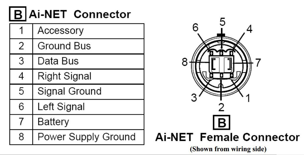

How about another direction / question......
Does someone know what the interface connector type or style is for the CD changer? I would like to try to work on my CD changer, but I need the ability to power it up...hence the interface connector.
The configuration is not one I am used to.
Thanks
Old Jan 7, 2024 | 11:18 AM
Stumpy's Avatar
Joined: Nov 2011
Posts: 581
Likes: 208
From: Devon, UK
This is the diagram of the CD changer connector
