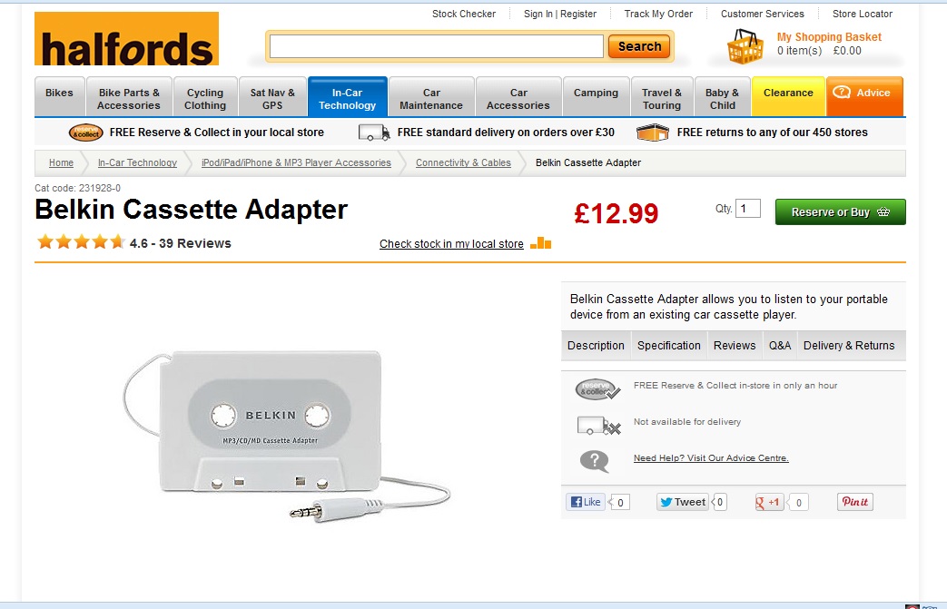

Old Mar 7, 2013 | 09:58 AM
Dennis,
I can find the old style Belkin cassette adaptors on Halfords website ......
but not this integrated Cyanix unit in beg3yrs link.....
Did you get yours InStore at Halfords?

Originally Posted by GGG
Dennis,
Attachment 35593
Attachment 35594
got it from halfords in shiley solihull about 2 years ago..and it works the same as the other adaptor..its give a different sound every time you push it in tinny or bassey because the tape heads are never in line unless your lucky..and plenty of hum at high volume..its in my garage someware ill dig it out
