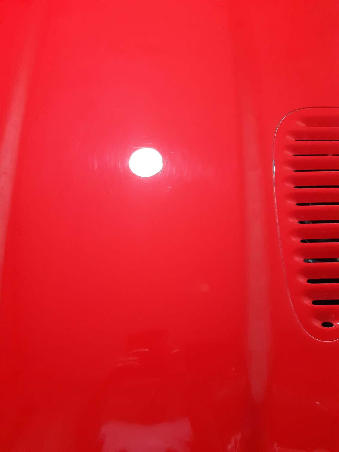

It looks fine in normal light but in the garage under bulb light you can see the swirls. That is the best I can get it with normal wax even with a MOP ... so the ceramic option I will definitely look into. 👍

I use a DA polisher and even wet sand with 2000/2500 grit if there are scratches. Clear coat is very hard and fine scratches are not easy to remove. It is also usually fairly thick and it's not easy to sand through it with very fine paper.
