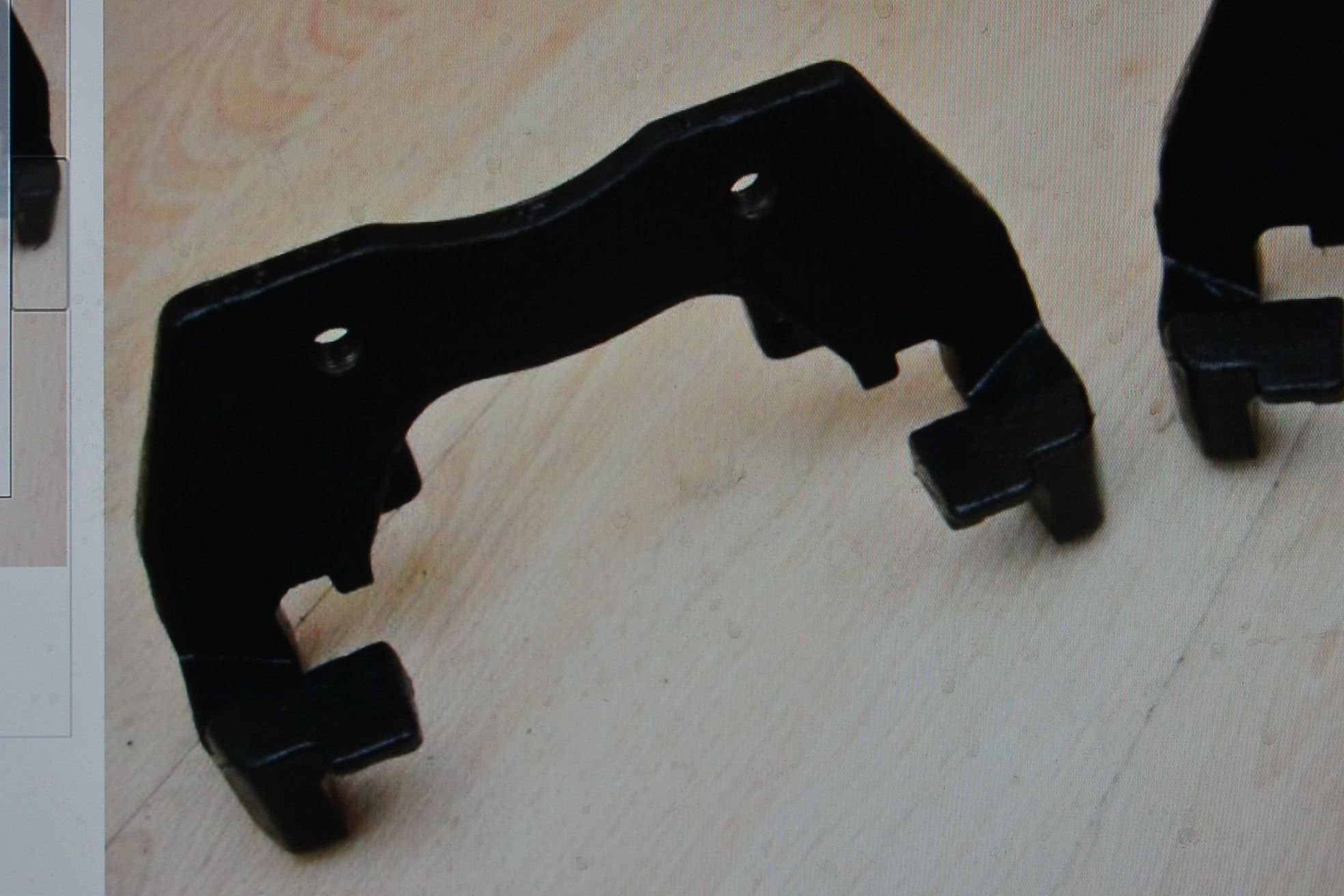

There are backets available that move the caliper out so it can go on a 325 disc . The discs and brackets are about £120 in total. If I am going to change the discs I might as well go large for the price.
Caliper Carrier

Originally Posted by Pistnbroke
There are backets available that move the caliper out so it can go on a 325 disc.
Aha! I did not know that those extended carriers were available.
How about posting up supplier / part numbers / as well as prices?
On that basis, many more of us will be interested in this upgrade.

I have 18 in wheels and there is loads of clearance even the backing plate is 20mm bigger than the existing discs. like you say if you are changing the discs you might as well do the mod.

Look Here From what I can tell the early cars had "progressive" brakes ie not too good so the brake booster was changed .Going to 325 will only give you 7% better brakes and the feel will be the same.
