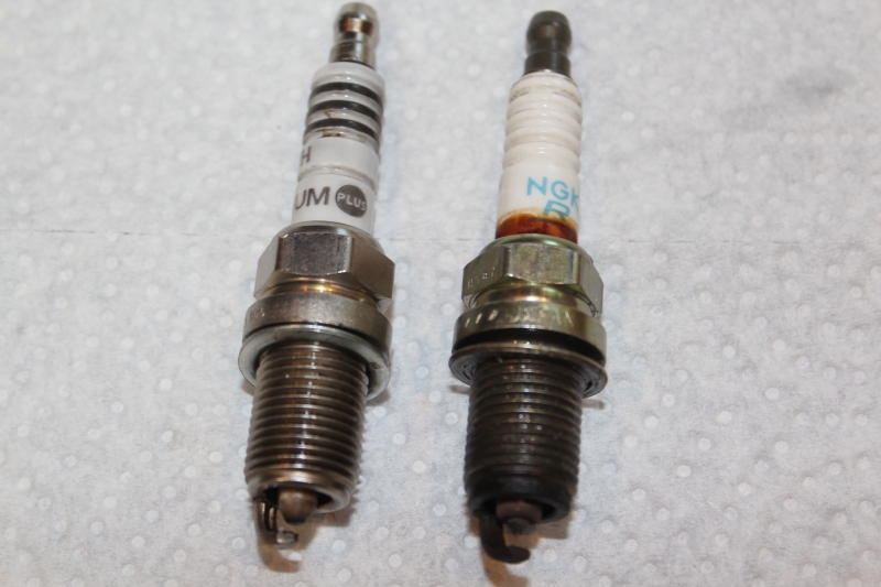

Thanks to all for their suggestions and I am not giving up yet.
I am attaching some pictures so that you can see what I have been up to.
All the new Bosch plugs were pulled and the old NGKs put back in and I have attached a picture showing them side by side for comparison.
I have more pics but I don't know if they would be helpful.

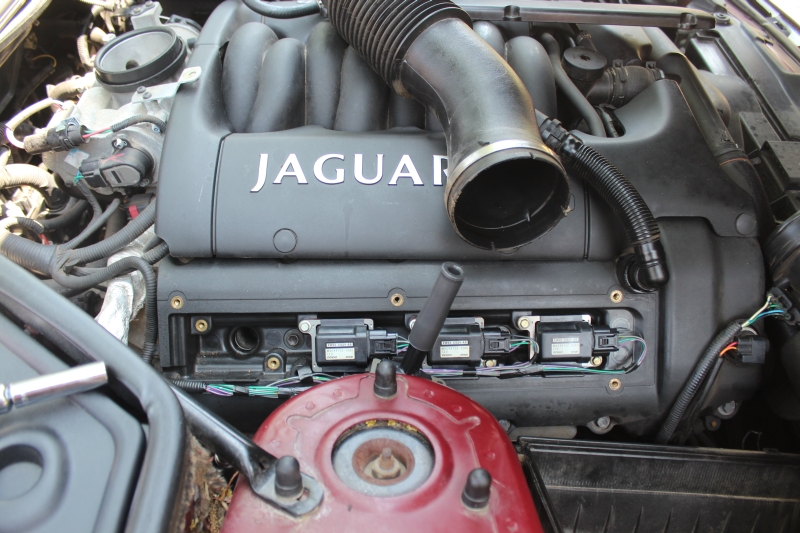

Moving the breather is easy and didn't appear to put any strain on anything. I did disconnect all the COPs and examined the connectors and they looked clean and trouble-free to me. I did not spray them with contact cleaner however.
I will try the procedures suggested once I read them all and get some more time to work on her, but thanks again to all.

Others have already mentioned this but I thought I would also after seeing your pic #2.
In that pic, it clearly shows that you did disconnect the plug from the MAF sensor which is mounted in the air intake. This is normal as you would not be able to move it out of the way without doing so.
Because you said that "I didn't disconnect anything electrical other than the negative lead to the battery", is it possible that upon reassembly you forgot to reconnect the MAF sensor?
That could easily cause problems & stalling.

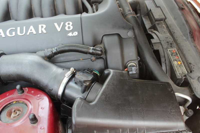

I may have removed a connector and forgotten that I did... not getting any younger you know. I am attaching a couple more pics of that side of the engine and maybe you could tell me exactly what you're seeing as I am not sure which part is the MAF?
And I know I could look this up but does anyone have a link handy to a procedure on checking the fuel pressure? Oops, just saw Gus already provided that in his post above. Thanks!

Originally Posted by RichD
I may have removed a connector and forgotten that I did... not getting any younger you know. I am attaching a couple more pics of that side of the engine and maybe you could tell me exactly what you're seeing as I am not sure which part is the MAF?\
In picture #2, the MAF is the piece between the airbox and the "tube" coming over from the throttle body. It looks connected in picture #3 if that is your current state.
But it won't hurt to recheck the connector and shoot a spritz of cleaner on it, just in case.
