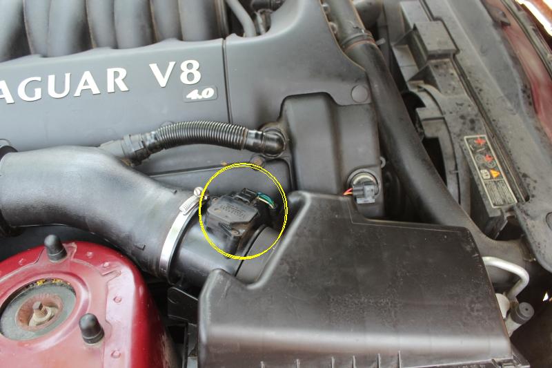

Here is your pic with the MAF (Mass Air Flow) sensor circled in yellow.
As Jag#4 mentioned above, it looks like the wire plug is connected to it properly. It wouldn't hurt to check to make sure the plug is seated all the way onto the connector.
