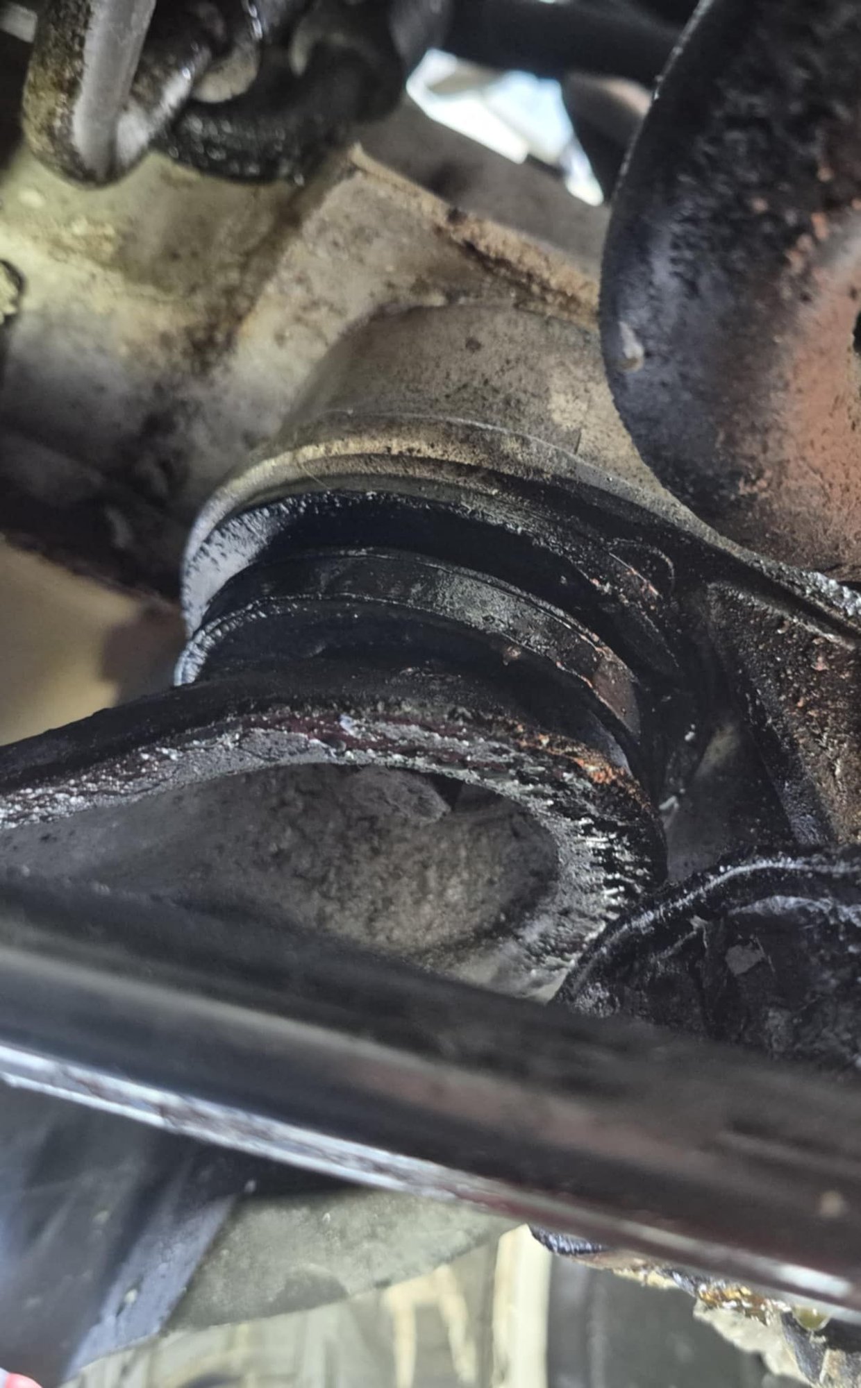

Are there any instructions for changing front motor mounts? 2000 XK8 Convertible.
My buddies 2000 XK8 needs the front engine mounts changed, one is leaking the other is collapsed and dry as a bone.
I have found several right ups on changing the rear mounts but nothing for the front. They look fairly straight forward but I always like to check ahead for and suggestions that you experts can suggest.

Those are not the engine mounts, those are the front subframe mounts. It's significantly more complicated. You will have to drop the subframe. And those don't contain fluid. What you're seeing is a motor oil leak, possibly from the timing cover or the harmonic balancer seal.

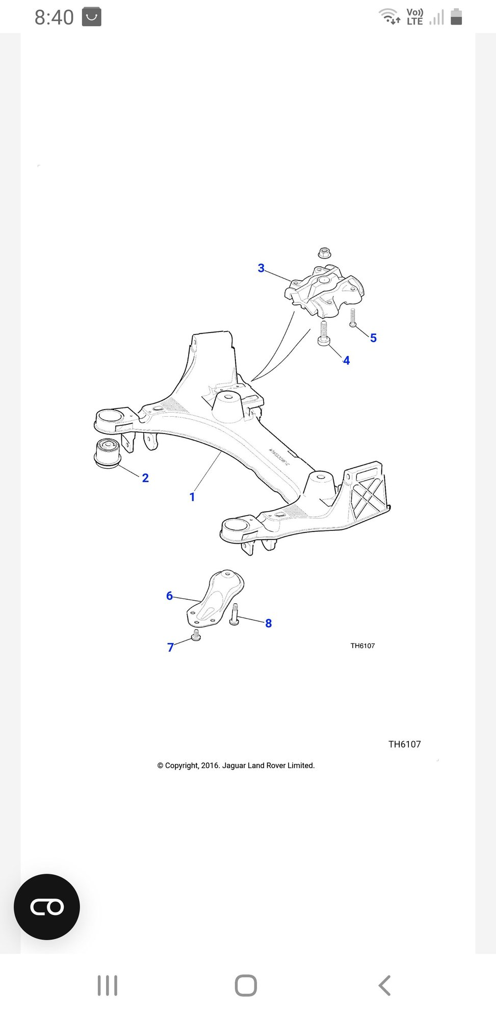

As Gian stated, front crossmember bushes.
l replaced mine several years ago, with crossmember in place, it can be done but would consider dropping the front end if doing the job again. they originally had a plastic body which makes it possible to "dig" them out with sharp chisel.
​#2 in pic. Part # MJA2370AJ

SNG Barrett USA are listing that part at $407 each (or $55 for a MaitaiHoPong after market part) , I'll schedule a kidney broker appointment before I do that job.

But the engine mount is not the part he actually needs.
