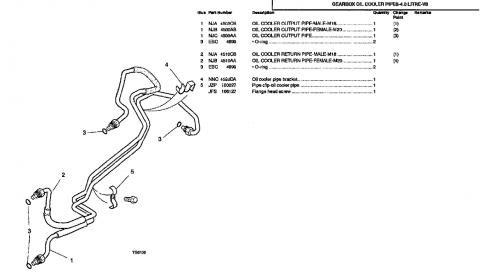

If you look on the left side of the radiator (facing out) you will see two lines going into it from the trans. On my 93 xj-s I had antifreeze in the trans from a leak in the end cap for the trans fluid and tha last time I looked I thought it was there on my 99 xk8.
Old Feb 11, 2010 | 09:10 PM
Gus's Avatar
Gus
Joined: Jul 2008
Posts: 11,356
Likes: 2,236
From: Berlin Md.
I hope this helps.
