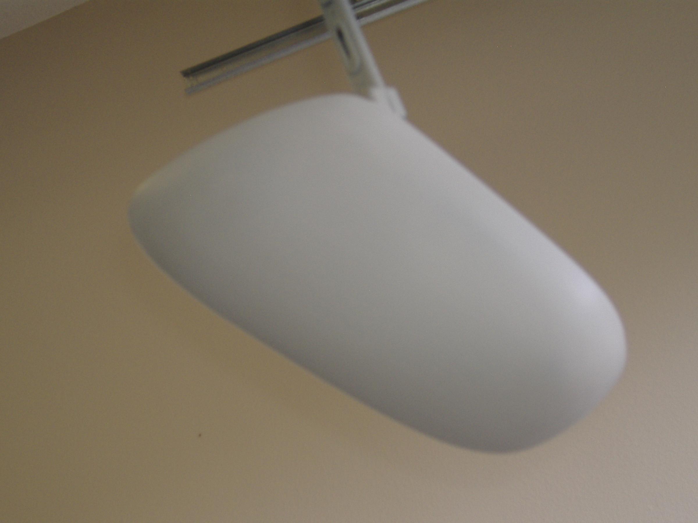

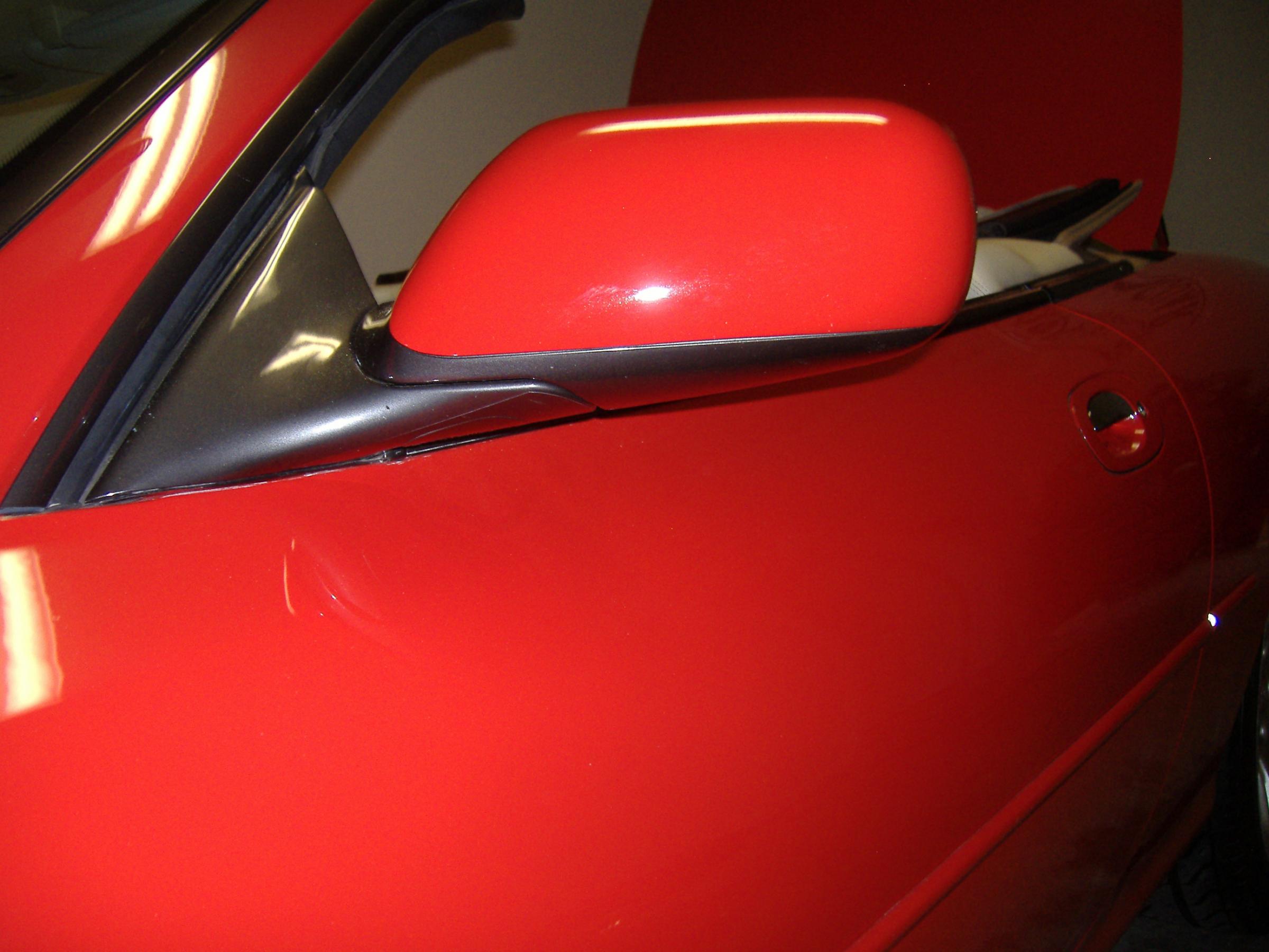

Having noticed the outside mirror covers have taken their good share of road rash,(normal chips and rock dings), I decided it was time for a repaint. I've been doing restoration/custom paint on auto's and bikes for over 30 yrs, actually started as a hobby/turned second job many yrs ago. 5 years ago I hung up the guns, sold all my equiptment, and decided to call it quits. So I thought.........................
Fast forward to today, and now wanting see my Cat as pristine as possible, the ability to "do it myself" overshadowed the thought of paying a shop to have it done. But, alas, I have paint equiptment no more. Soooo... here in lies the alternatives! I have had a loathing for "cheap rattle can fixes" and backyard paint repairs. But, have found that technology in that respect has grown in leaps and bounds. So, I jumped in, and after extensive research and came across automotivetouchup.com.
Reviews were good, so I made my purchase. Their site claims to custom mix and color match to our OEM color. I purchased the following
12oz aerosol 1924 Phoenix Red
12 oz aerosol easy sanding gray primer
12oz aerosol plastic parts adhesion promotor
12 aerosol high gloss clear
2k urethane clearcoat aerosol (yes, catalyzed urethane clear in a spray can!!!)
All told, about $74.00 in cost, including freight.

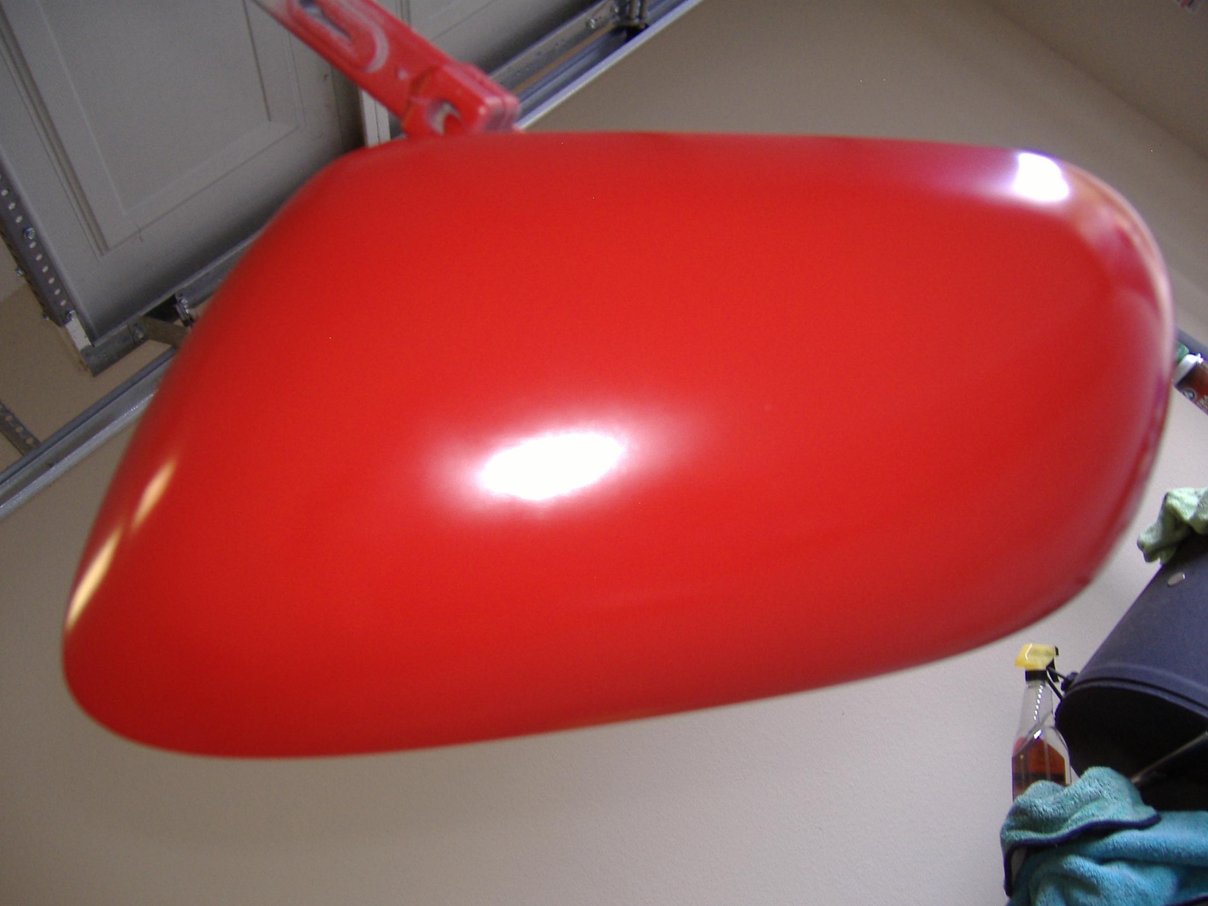

I removed the mirror covers, and sanded both down to base plastic, 220 dry first, then 400 wet. I removed ALL original paint as to avoid any lifting issues caused by fast drying new paint. The adhesion promotor was an extra that may not have been needed.
After sanding, cleaning, then preping, I began with the adhesion promotor, letting dry as reccomened, followed by primer. After several coats of primer, of which I allowed proper dry time, I again wet sanded with 800, cleaned preped, and was ready for color.
3 coats of color, letting flash between coats, then 2 coats of high gloss clear. Let me say, having owned some the BEST paint guns made, (SATA, Iwata,etc.) this stuff shot beautifully, laid down smooth, dryed quickly, temp was about 75 degrees.
Most of all, the color match was "dead nut on the money"!!!!!
Thank You, automotivetouchup.com !!!!!!!
Next step is to again wet sand w/800, then 2 or 3 coats of the 2k urethane clear. Now this I find amazing, as shelf life of catalyzed paint is short. To activate, you apply a special "button" in place of the spray head, push it down, replace with spray head, then shake to mix. You now have 24 hrs to use this clear before it hardens beyond use, amazing.
I have yet to shoot the urethane, (temp dropped) so I'll shoot it on the next available warmer day. I highly reccomend this to those of you looking for professional results with ease of use. Hmmm, maybe the front fascia next? I'll let the picks tell the story

I use a base clear to protect my base color, works even better if spraying pearls or metallics, when color sanding between coats. keeps from sanding through your color without using expensive and slower drying catalyzed clear. I wet sand between coats to keep build low and make my surface as smooth and clean as possible. I realize this is an extra step, but will give you the best possible end finish. These extra steps turn an average paint finish into excellent end results. The high gloss clear is low build, 2k much higher build. You want to keep from to heavy final build, as is more likely to chip. Also allows you to nib out airborn dust and trash, as we all want a smooth, clean final finish. After proper dry time you can also color sand, (2000 grit or better) your 2k clear, and buff and polish to mirror finish. But, be carful, if matching OEM finish, to smooth and slick may not match, remember, most OEM finishes have a little (ok, sometimes a lot!) of texture, sometimes called orange peel or eggshell. Use your best discretion to match your factory finish.
Yes Graham, replacing parts with non original color are best to be stripped to substrate before recolor, this avoids any possible bleed through or reaction with old paint. I'll post more pics after the 2k clear has been applied, temps under 70f for the next few days, catalyst takes much longer to "kick" when cool. Best to have temp over 72f.

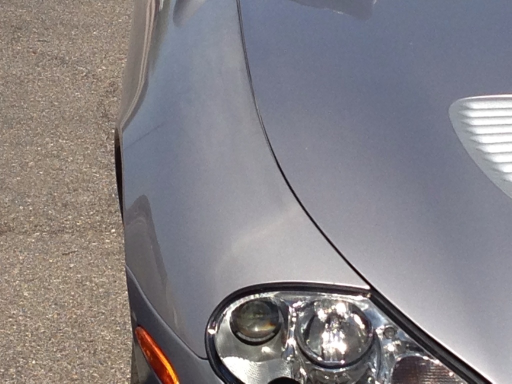

Default Bought it this way...

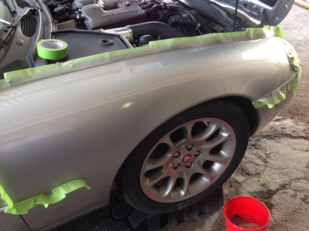

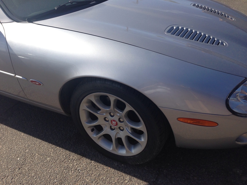

This is how the fender was when I bought the car last year. Whoever repaired a ding in the fender had no clue what they were doing. The grey that runs along the fender edge near the hood is just that... grey primer with a few atoms of silver metallic on it. It's time to get this fixed! I'll do it as soon as the paint supplies get here. I've painted a lot of things, but still appreciate the input. I'll do it like you suggested.

I see your issue of repair, hate to see shoddy work on such a regal ride, as your car looks great. Shoot a test (color and base clear) on the color card that comes with your paint supplies, then check against your best surface for match, especially metallic. Remember, you already have one repair possibly over original paint. Decide whether to shoot whole fender, of which I would then strip,prime, block, then shoot and clear, which is most labor intensive, or remove all old repair material to avoid any reaction (lifting) when new paint (especially if blending) is applied.
You seem to have things under control, as I see from your other posts your pretty crafty. Hope to see your repair looking like new, pm if me if I can help in any way

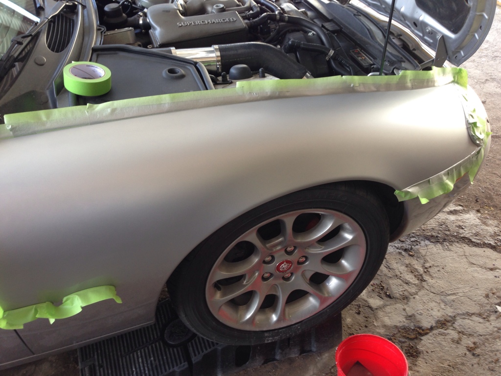

I shot the fender today. It's got several layers of clear now. I'll wet sand it tomorrow then hit it with the catalyzed clear. The color match is about 98%. The paint is new and nicer than the factory spray. It is certainly better than it was and will suffice until I get a complete respray. =)
I'll do the scuffed rear bumper over the weekend.
It didn't take long at all!
