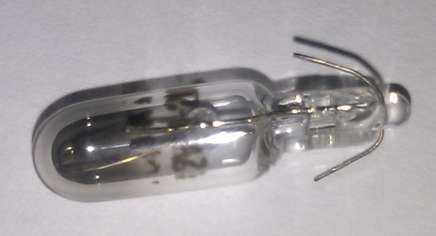

Ok, after finding no voltage in the socket with a multimeter I decided to open up the centre console. There was voltage in the leads which go to the lighter and to light bulb so the problem is the socket itself which I dismantled as far as I could to clean it up properly. I managed to get the light bulb out too but I'm not sure what's the type of it and where to get a new one (see the attached pic). The texts on it are a bit worn off. I can read 12V and 1.2W or 2W but the rest is a mystery. On the plastic socket it says D01EC. Is this perhaps the type of the bulb? Any help would be much appreciated.
Thanks,

A-ha... I think it's this one: http://www.amazon.co.uk/286-Capless-.../dp/B002BB53IU
Just need to find a store somewhere near here where I can pick one up

It is just a standard T10 capless bulb, they are used all over the place on the XK and by hundreds of different cars, you will get one easily in Halfords.
Hard to say by the actual pic but there they do a smaller type too. but again Halfords will sort it
