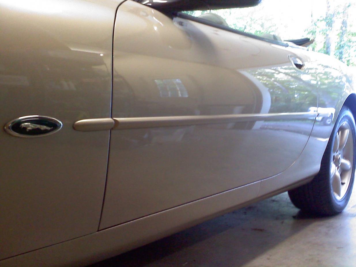

I did the clay detailing the other day, and she came out looking great. Now my color is not dark, so you don't get the deep wet mirror effect, but none the less I liked the results.
I used the Meguiars smooth surface clay kit, followed by the Meguiars cleaner wax (included in the kit) and the Gold Class Liquid wax. Used about 2/3 of the quick detailer spray on the whole car for the clay lube. It came with 2 clay bars. I used one, and can use it again stored in a zip lock bag.
It really brought out the shine, and is smooth as glass to the touch. Most of the dirt was on the front nose and rear bumper. The whole job took about 4 hours from wash, clay, to final wax.
This is after. Don't have a before pic but it was pretty clean to begin with. It is well worth the time, even if you think your ride is clean. Cheers!
