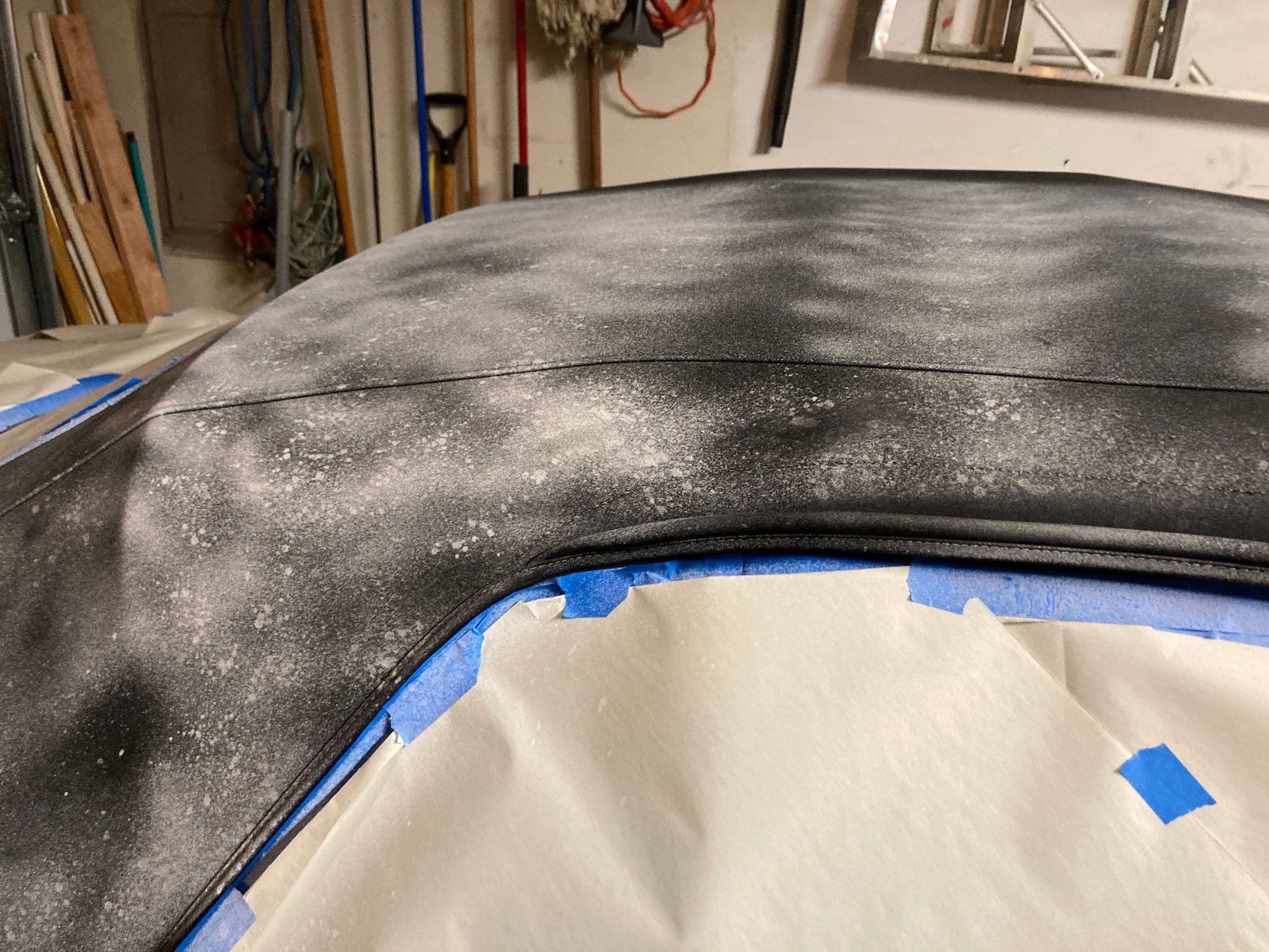

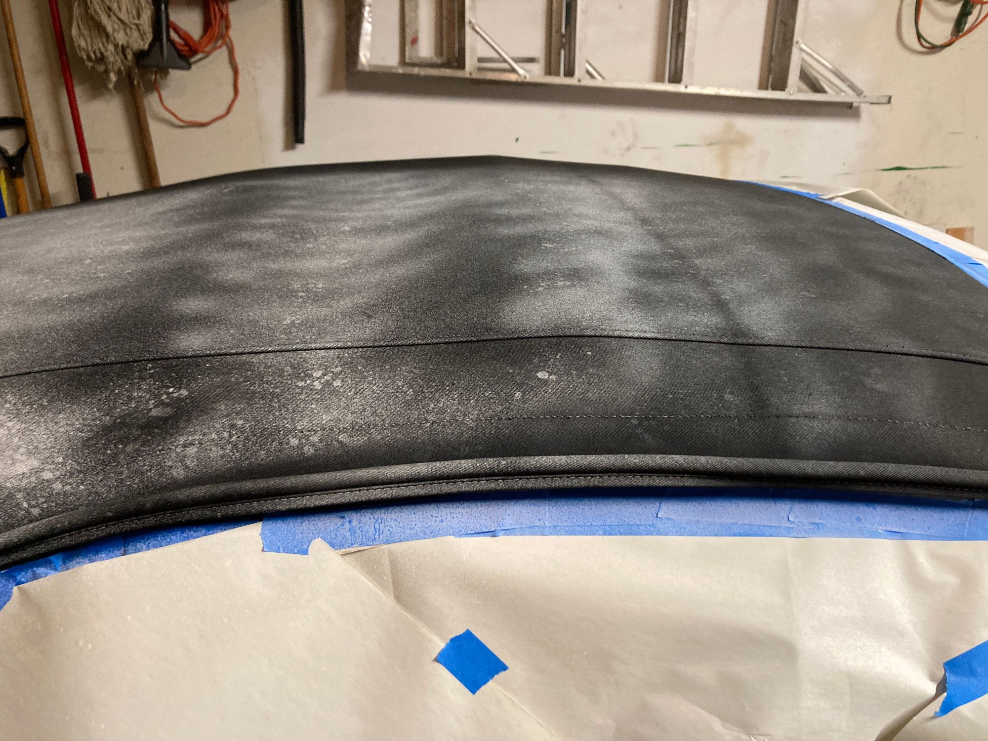

Bought my 2nd XK8 this year and finally got around to working on the canvas top. It has a black top and was really needing a good cleaning. I had some left over 303 brand cleaner from my last XK8, the much missed Blue Cat. Applied, washed off and it suddenly looked almost new. Let it dry overnight.
I had to buy a new bottle of 303 Fabric guard as I was out. Have used this product multiple times before on the previous Jag with great results. I sprayed it on as directed and waited on it to do its thing. Went out in the garage in a few hours to see how things were progressing and found what you see in the attached pictures. The entire top was covered with this white coating. It was dry so I tried brushing it off. That had no effect.
Back in the house to search the web and found multiple threads on various forums about this same problem. I went to the company website and found the following note on the description for the fabric guard: We have recently discovered there is a quality issue with some of our most recent production runs of our 303 Fabric Guard Formula. This could result in the product leaving white residue on your fabric after treating/drying.
Now they tell me. Multiple cleaning and brushings with Dawn and the residue is mostly gone; however, it has left me with ZERO ability to shed water. Sheds about as well as it did before I started. I have requested a refund. We will see how that goes. Meanwhile I have some Raggtopp on its way since I still need to seal the top against water.
Not a rant so much as a warning. Thanks for reading this far.

Just a quick update: I finally contacted customer support since I had not heard anything for over a week. They told me a refund typically takes 4-6 weeks to process and I should look for a check in the mail. Guess I'll consider that my Christmas money.
I did buy and apply Raggtopp sealant. Very easy to use, cleans up easily and most importantly works like a charm. Water just beads up and rolls off now. Very happy with it.
