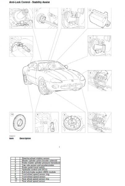

I understand and accept the issue with the circuit board on the 4.0 litre models as a regular issue but don't think this applies to the 4.2 litre models.
DSC (Dynamic Stability Control) adds another level of complexity with the addition of Yaw Control on the 4.2 models. This supersedes the simpler ASC (Anti-Lock Braking System, Traction Control) on the earlier 4.0 models.
Where the earlier ASC causes frequent issues with dirty Wheel Speed Sensors and the ABS Module circuit board, DSC adds several other controls and sensors e.g. steering wheel angle monitoring:

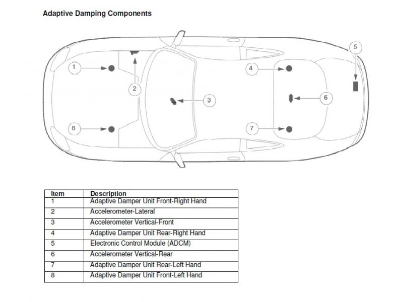

The number of extra sensors in the Adaptive Damping makes for a frighteningly complex system with many more possible sources for faults:

The reason I don't think the ABS module is the cause of DSC fault warnings is because these only appear when the vehicle is cornered hard and they clear at the next ignition ON. A circuit board break wouldn't do this.
I'm waiting for the bad weather when I can hook up my AutoEnginuity and record monitoring up to and beyond the point DSC error is invoked. This should give a better indication of the contributing factors.
