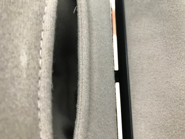

Fixed! Solution was to manually latch the top (as suggested above - thank you). Thought I would post pictures for next newbie like me...

Default 3 - Manual convertible top latch
remove plastic cover for allen wrench access - above rear view mirror
Turn allen wrench clockwise so latch pops up - I had to push the top up about an inch to allow latch to come up
Let top down into latch and turn allen wrench counter-clockwise for latch to lock
now close valve in trunk clockwise back to automatic operation
Presto - use console switch and it all worked.
Thank you everyone!
