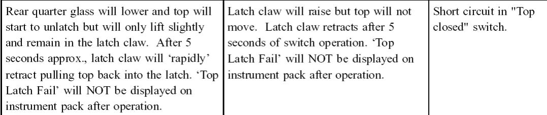

I have done what you and Spurlee did, to wit., removed the header panel to lube and clean hardware and switches. Operation is still intermittent, and unreliable. Either pushing up on the header bar, or cranking over the claw to force it open is the override that I use to open the top. I am convinced the problem lies in one of the switches; and for that, I will need to remove the latch. gordo

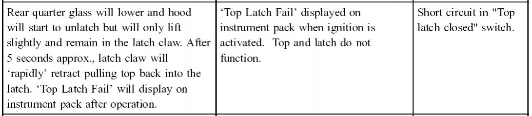

Gordo this is on page 8 of TSB 501-11 and you can find it on my page and in the FAQ area of this forum. I have not removed the entire header to check the 3 switches but after looking at what appears to be the same type switch that was in the door latch. I elected to use the WD40 to loosen up the pivot point of the fulcrum for the switch located at the latch and it worked for me. I will look into it further if it becomes a problem again but today is it was a fix that worked. I have been short on time but I will try to get something posted with additional photos on my page.

There is no warning displayed in instrument pack. So I guess the fault must be a "Short Circuit in Top Latch Closed Switch".
Am I correct interpreting the term 'short circuit' to mean 'failure to open'. Not a short like we think of the term, e.g., a shunt.
You are correct.
