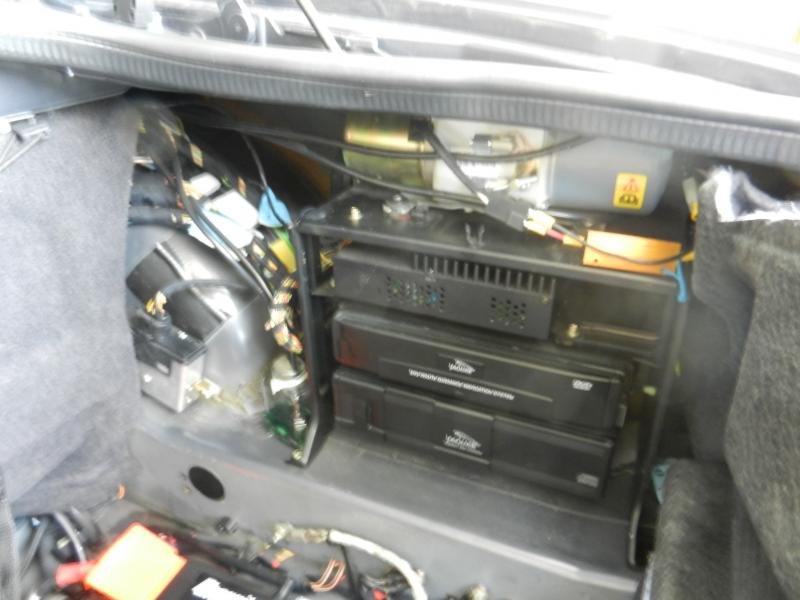

Just finished my mod too. Heres a pic.
Attached Thumbnails Convertible top: conversion to manual latch operation-picture673.jpg
