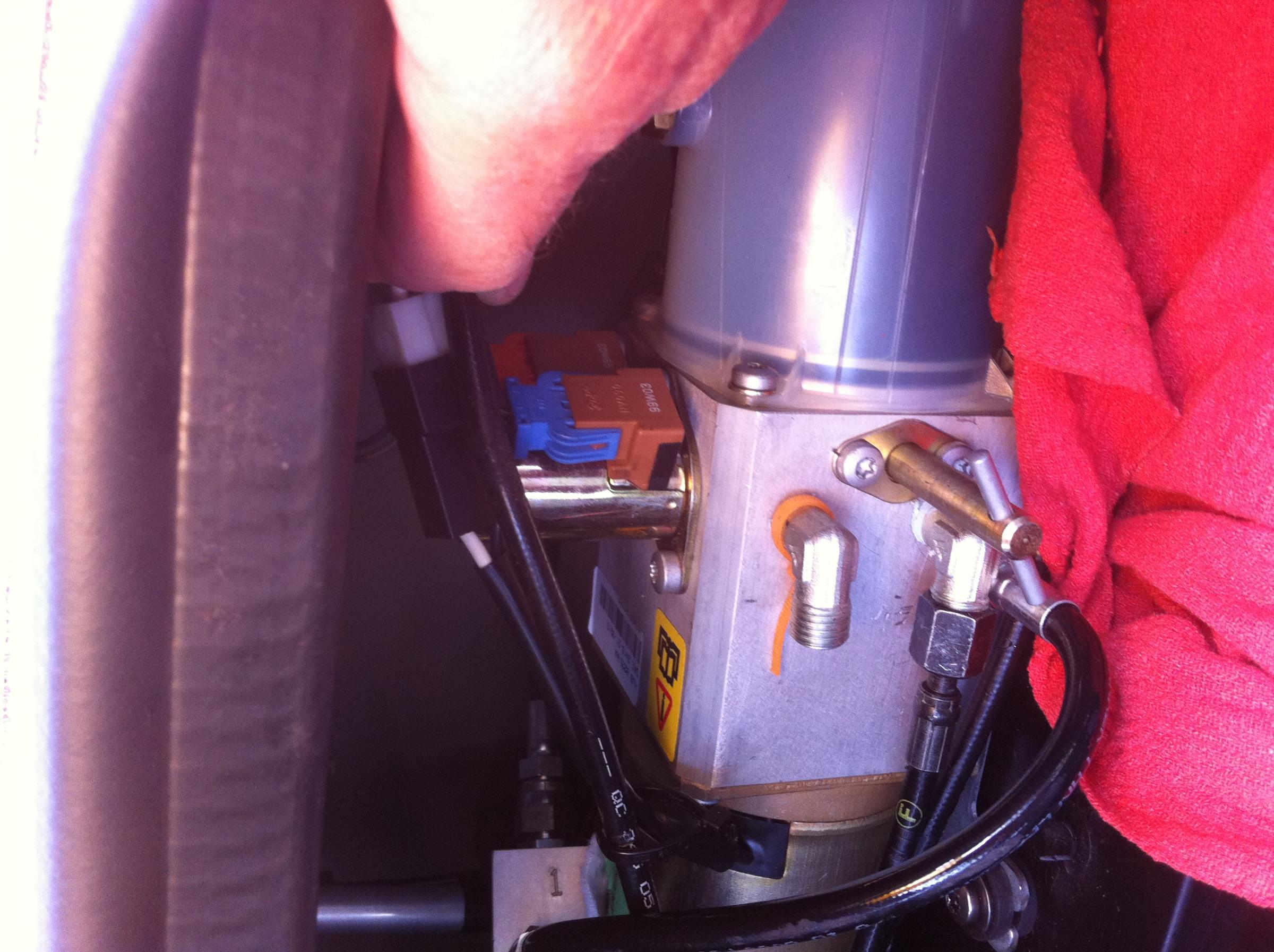

Can you post pictures of the latch hose fittings at the pump end, with the fittings opened?
(The stock fitting will have a thread pitch of 1.5 mm per turn ... 6 mm for 4 threads)

Default pictures
If picture is not good enough I,ll try again, as I,m new to this new tech. stuff

Just by eyeball, that stuff all looks stock to me.
Do the components Larry sent you look like those shown at the "manual latch" link in my signature line below?
