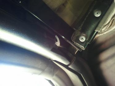

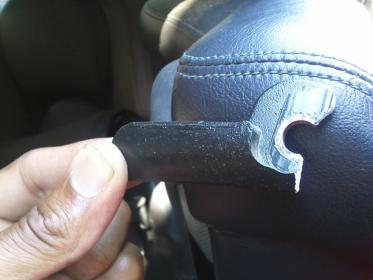

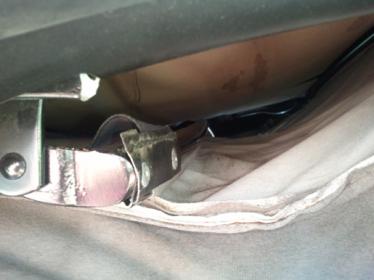

These are some of the pics as you can see one of the frame rods is pertruding downward but like I said the top goes up and down without problem no noise or sense of strain its just this bar is defenitly in the wrong place. Pushing on it does nothing it does not move.

Attached Thumbnails convertible top hell-pic1.jpg   convertible top hell-pic2.jpg   convertible top hell-pic33.jpg   convertible top hell-pic4.jpg   convertible top hell-pic5.jpg

Bad news. That broken piece is from your rear side frame rail. You are going to need a new top assembly. Best bet is to get one used from salvage.
This migtht be covered by your insurance.
