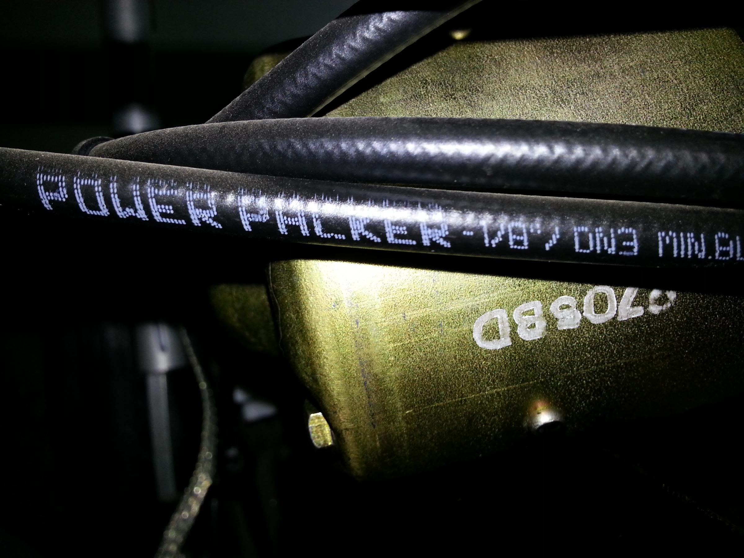

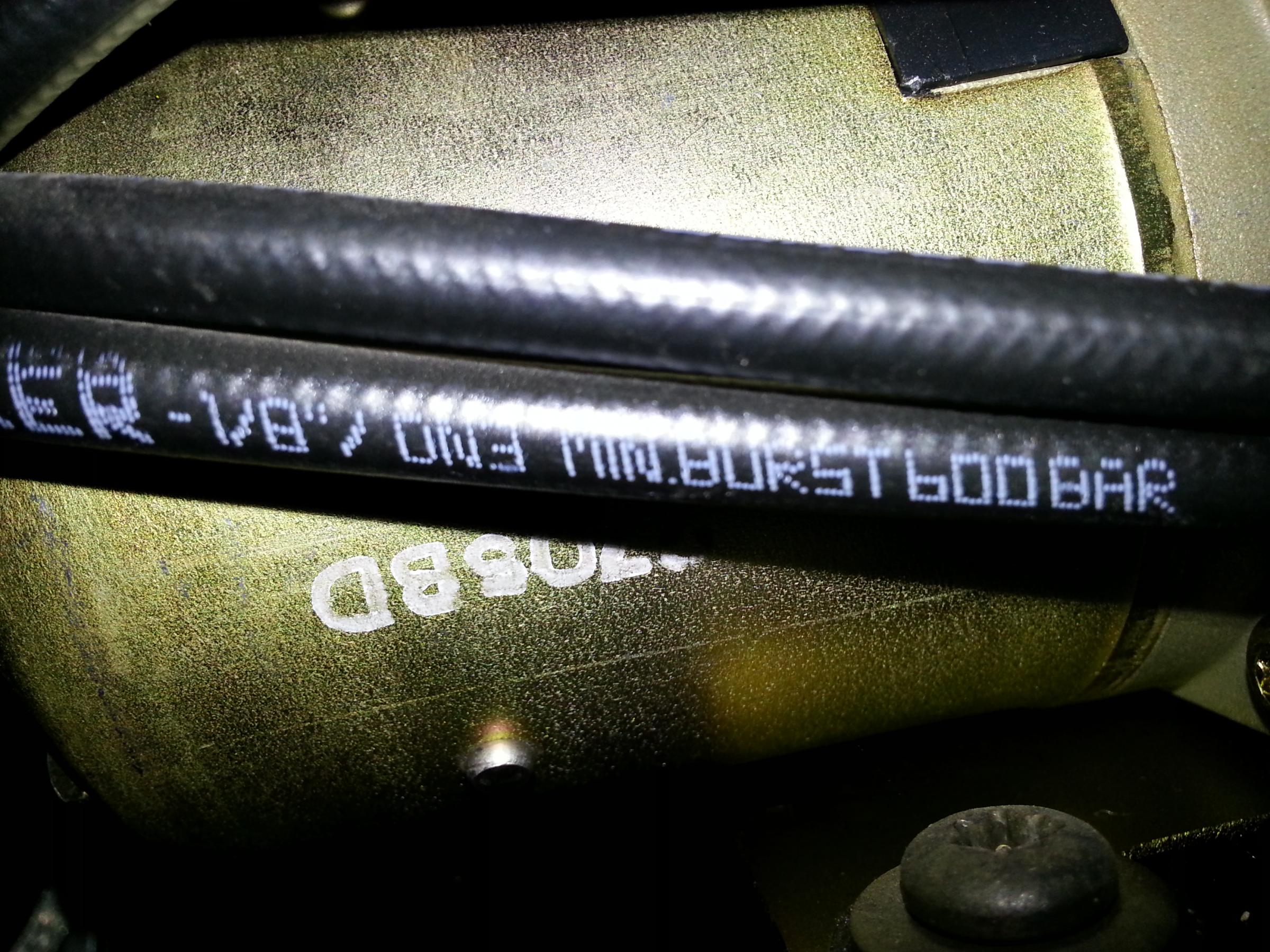

Gus.
Is this the old type "good" hose. Taken from my 97, VIN 011XXX
Attached Thumbnails Convertible Top Hydraulic Hose Leak: What Model Years?-20130403_234215_1.jpg   Convertible Top Hydraulic Hose Leak: What Model Years?-20130403_234209_2.jpg
Old Apr 7, 2013 | 05:26 PM
  #80
Gus's Avatar
Gus
Joined: Jul 2008
Posts: 11,356
Likes: 2,236
From: Berlin Md.
Look on the hoses and see if they are marked with Power Packer 303 or 363 on them.
The hoses Parker/PowerPackers in the photo are 600 BAR = 8,702 PSI and they are the ones in the earlier models. I would say that your hoses should be good with the 1600psi from the pump. The 303 & 363 hoses are the ones you need to be concerned with. However, We found several latch and lift seals blowing out causing leaks because of excessive pressure. Installing a PRV would help with the seals but your hoses should be OK without it.
Originally Posted by oyster
Gus.
