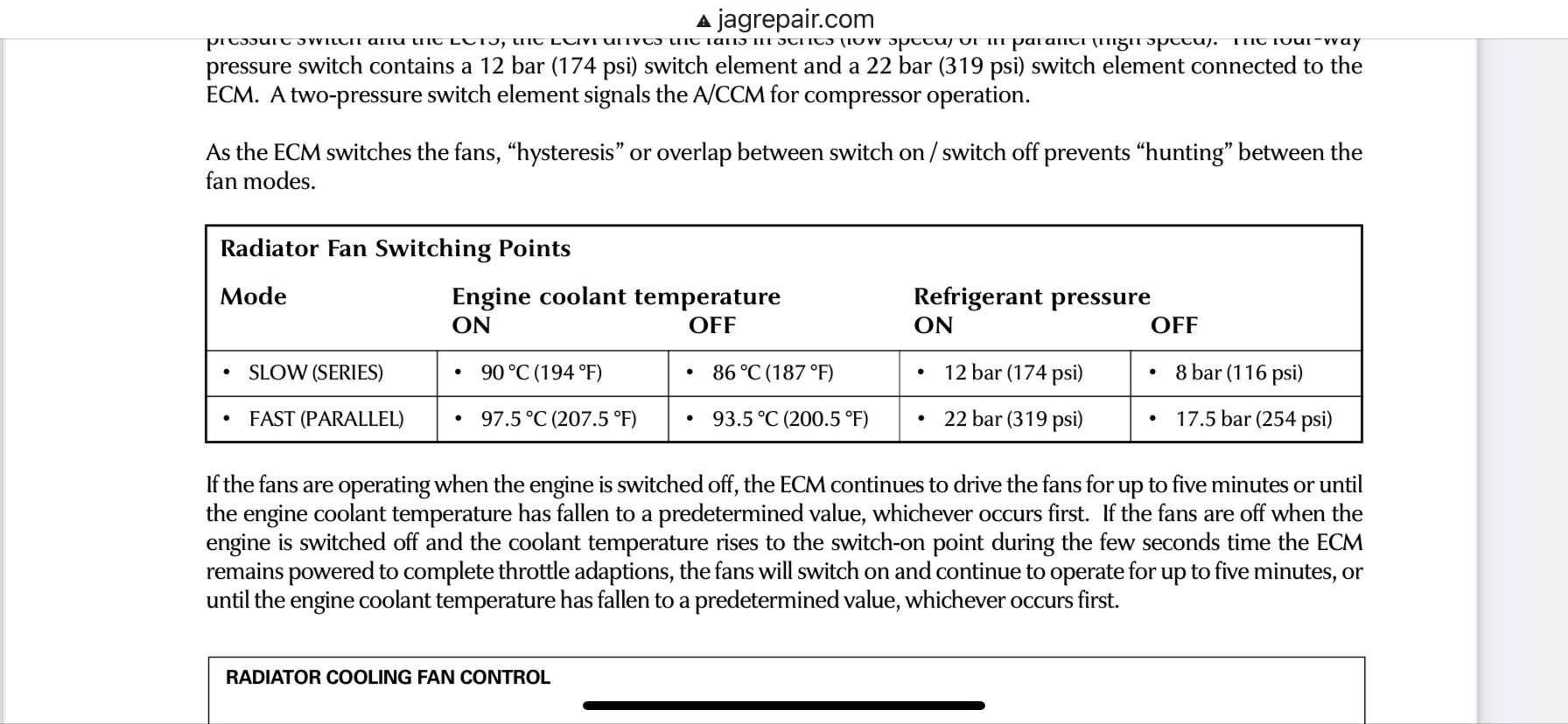

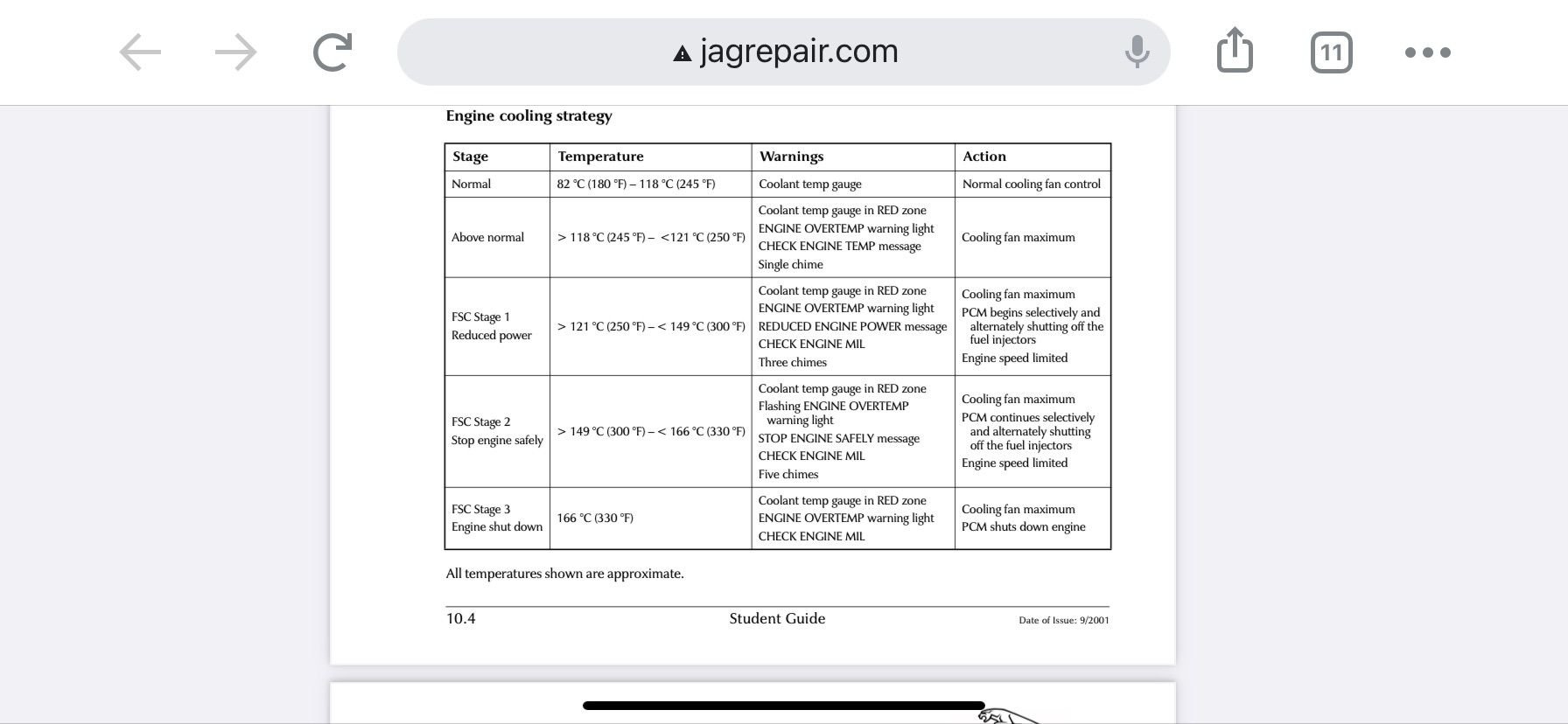

Do these charts help ?
turning on the a/c should turn them on.

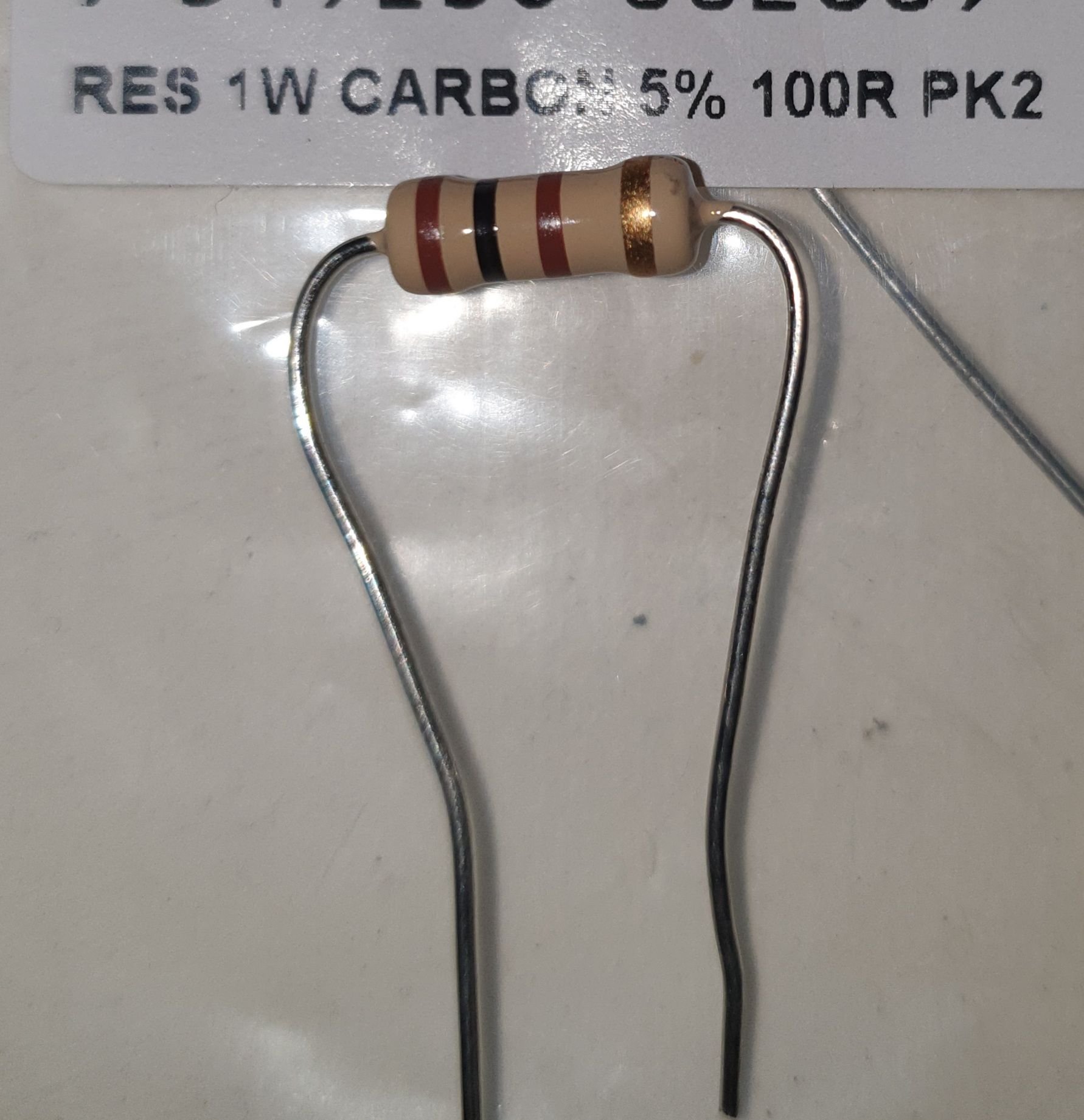

No. You can jump at the temp sensor plug with resistor shown which will turn them on. A/C being on is a hassle and not definitive because of pressure switch involvement,

if i read that correctly 100 ohm 5% 1 watt resistor ?
what is range of resistance that willwork

Sorry but that's a question l can't answer. Just know it will mimic fan on signal. Unplug at temp sensor insert resistor into plug, ignition on, fan runs, if not something is wrong.
