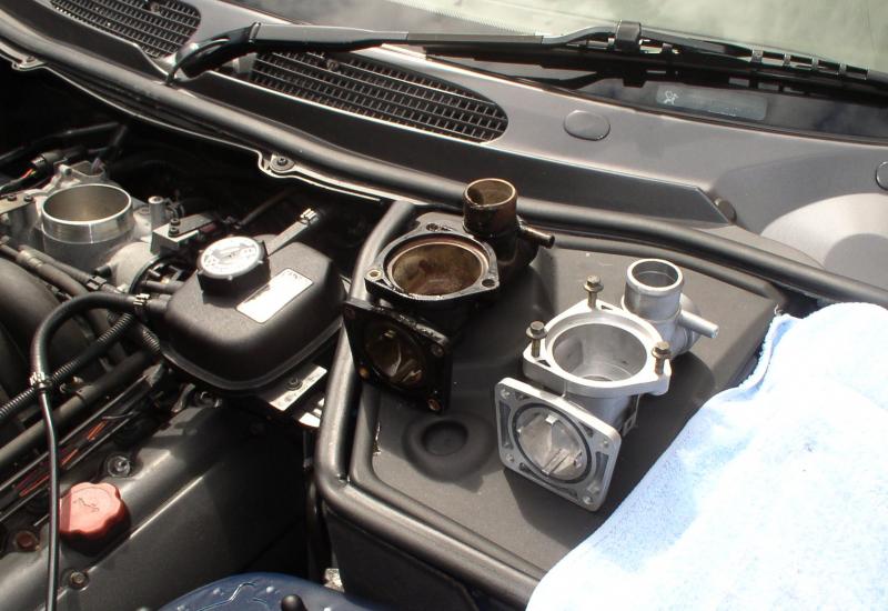

If you do need to replace the Thermostat Housing, a popular upgrade is an aftermarket aluminium version:
The aluminium aftermarket one on the right is far better than the OE Jaguar type on the left.
