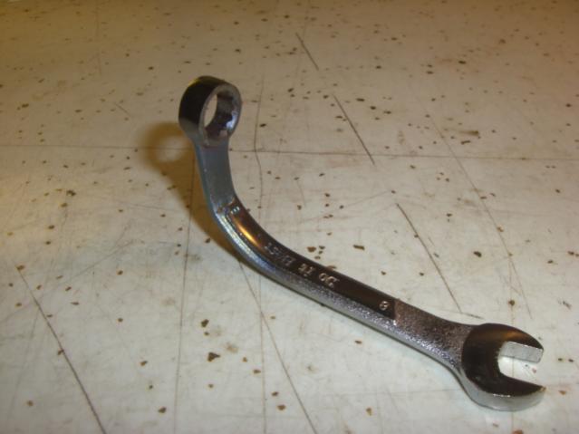

Bent Wrench Trick
The two rear hold down bolts on the t-stat housing are indeed difficult to reach. Buy a cheap 8 mm box wrench. Heat and bend it 90" and use vice grips to turn it. The front two bolts may be accessed using a ¼” drive and swivel; but the rear two bolts have limited access.
Use Vice Grips
The bent-wrench should be used in conjunction with a needle nose vice grip, and another regular style vice grip twisting the first.
The box head end provides for a tight and secure grip on the 8mm bolts. Using the vice Grips, there is plenty of torque available to tighten the housing base down without fear of stripping the bolts or scraping your knuckles. Forget about the ground down sockets... this is the tool to use.

Bent Wrench Trick
Use Vice Grips

Bent Wrench Trick
Use Vice Grips

Bent Wrench Trick
Use Vice Grips
