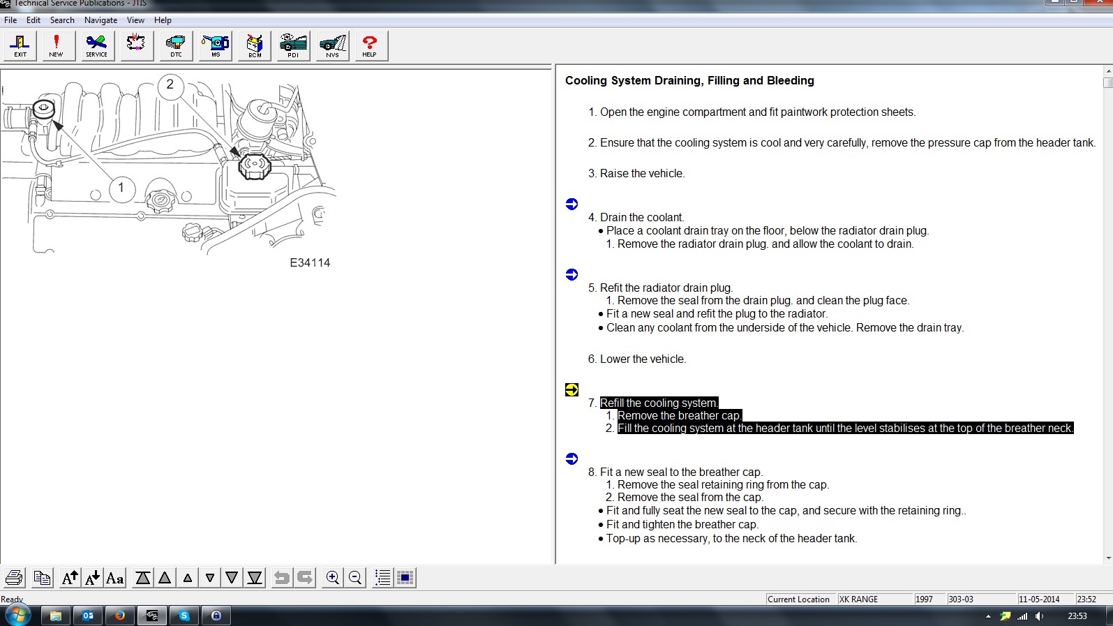

What is the purpose of that cap?

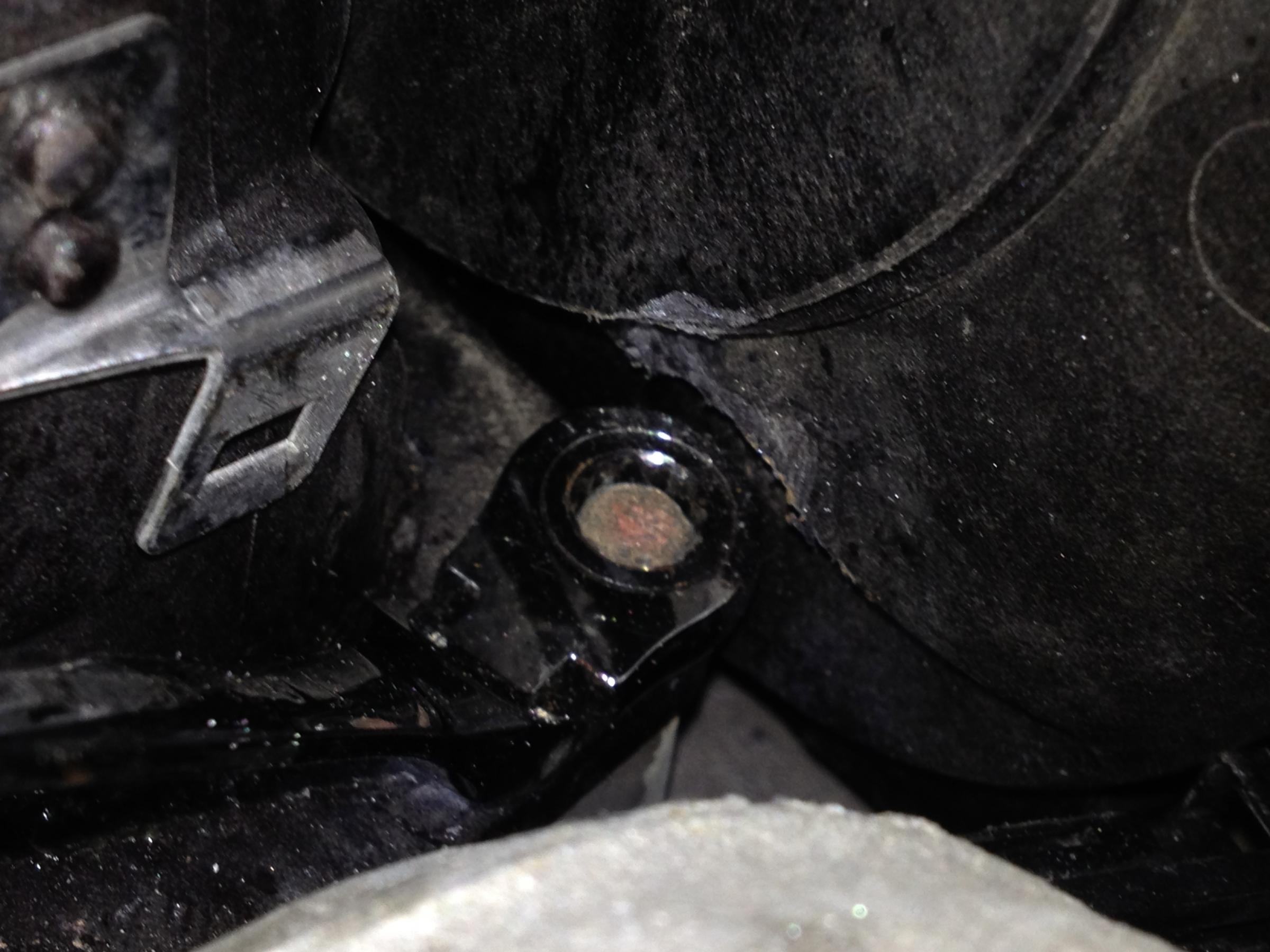

Also for anyone replacing the cooling tower. I used a flexible ratchet and filed the plastic manifold enough to get the ratchet on it.

The 10mm Allen slot in the top of the cap sure is inviting but loosening it that way is guaranteed to break 10+ year old plastic. A rubber strap wrench is the better way to apply torque.

The original Jaguar procedure for refilling the 1997MY was to remove the Breather Cap (item 1)
This procedure was revised in later MY's when the second return pipe from the Expansion Tank to the Radiator was deleted and it was no longer necessary to remove the Cap.

Thank you! David.
