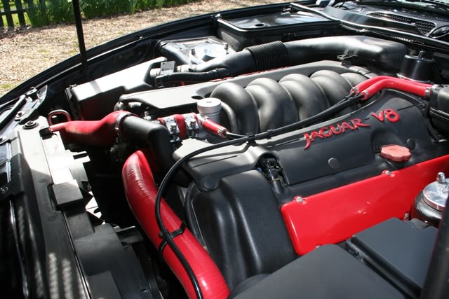

Some use both some dont, I have no explanation as to why this is, but from the pic below you can see this XK does
