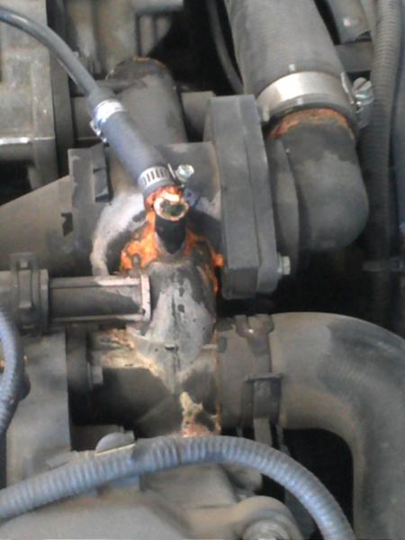

what would cause this in a 2003 xk8

I tighten everything. but it still leak
The hose from the expansion tank has a jubilee (worm drive) clip on the end that's been leaking coolant.
Someone has been there before and replaced the standard norma clip with this jubilee (worm drive). It may have been overtightened and damaged the pipe branch it connects to or the problem may have been with the short connector hose in the first place.
Check whether the end of the short rubber connector hose is perished. They aren't expensive from Jaguar.

I check it out. After i loosen the clamp the was NOT snug at all it seem like it was wore out I'm going to get a new one should i get the jubilee clips. also the Thermostat housing is leak form the side is the system over pressurized.

The expansion tank bleed hose normally comes complete with size 14 Norma clips.
Norma clips are used on plastic cooling systems because:
1. they're quick to install in the factory
2. they always fit right when clipped up - no risk of overtightening
I always use them to avoid damaging the small outlet from the header tank or the inlet to the thermostat housing. Easy to crack these with overtightened jubilees.
The photo with your first post shows the radiator top hose has also got a jubillee clip in place of the standard type and the hose has been leaking at some time.
Is this car new to you or do you know its maintenance history on hoses / thermostat / water pump replacement?

The plastic thermostat housing assembly on the 4.2L on your 2003 starts to break down with microscopic cracks at around the age of your car. You are going to continue to have problems unless you replace the whole assembly, pn AJ89486. It includes the plastic pipes, all the seals, a new thermostat and coolant sensor. It is actually not too badly priced, about $88 list.

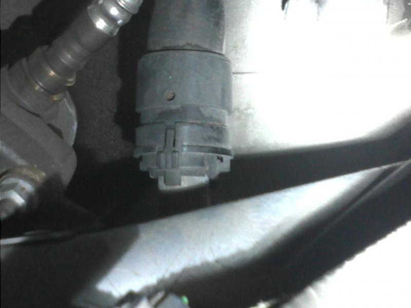

Default Another coolant leak
I found another leak i think is why don't have any heat. i read some where if you have if your low coolant light is on then your heater wont work. But any way can some tell if the is a seal inside here its leak a little more than the housing.

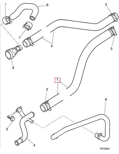

It might help to see the parts list for these:
coolant problems-xk8-heater-pipes-feed-return-graphic-.jpg coolant problems-xk8-heater-pipes-feed-return-parts-.jpg
These connectors (which I won't name!) need a special tool to release them. Are you sure you have a leak there? They look dry to me.
The low coolant light may be on genuinely indicating the coolant is low or could be a faulty sensor in the expansion tank. As long as the tank is showing coolant up to the filler neck, it's OK.
Attachment 16563 Attachment 16564
What's the name of the special tool.... it leaking from the bottom of it.
Look for a 'fuel line removal tool' the right size.
Alternatively, the new hose comes with a plastic ring on it you remove after the host is clicked into position - this ring opens up the locking clips. Take it off and use it to open the locking clips on the old hose then put it back on the new one to fit it.
