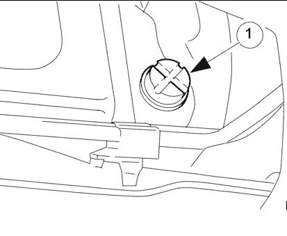

I have been trying to fine the drain plug on the rad. No luck. Parts will not be here till tomorrow, and its Super Bowl Sunday. Tailgate with a few friends, few adult beverages, unhealth food that tastes great or work on the Jag. This is a tuff one!! Jim
Drain Plug is on the right hand side and facing the engine - not on the bottom of the radiator. Black plastic plug with a cross head.
Attack it from underneath the car.
