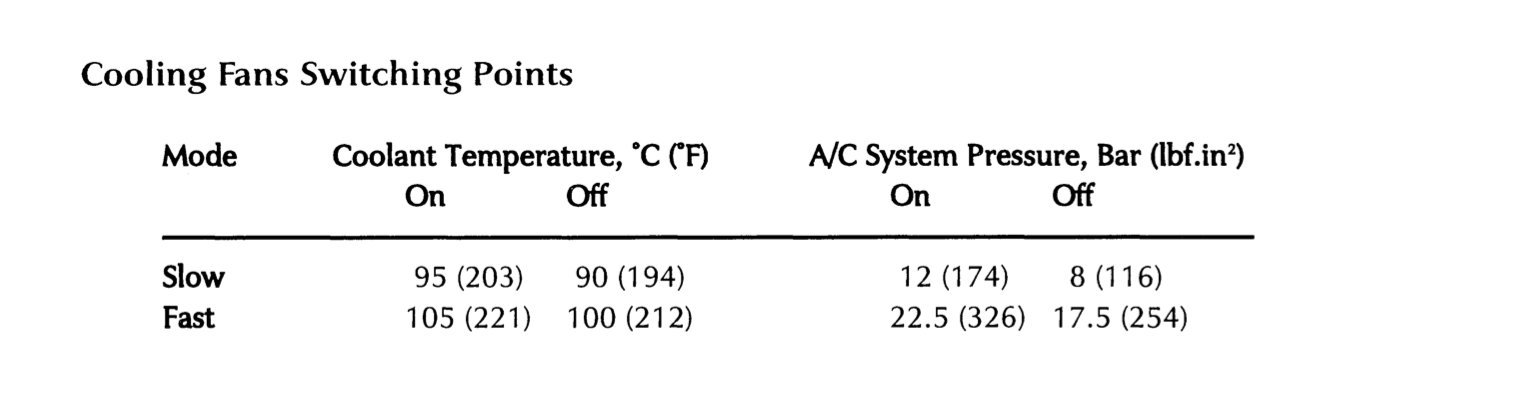

Are you sure the engine is getting hot enough? They don’t come on till 95C…. At least on the XJ8, can’t see why it would be different on the XK!
From the XJ8 workshop manual

The manual seems to indicate that it will only turn on when the AC pressure gets to 12l bar 174 psi.
If his gas was low to start with then it wouldn’t instantly turn on. I had it with my own car that the AC had to be on for a minute or two before fans kicked in.
