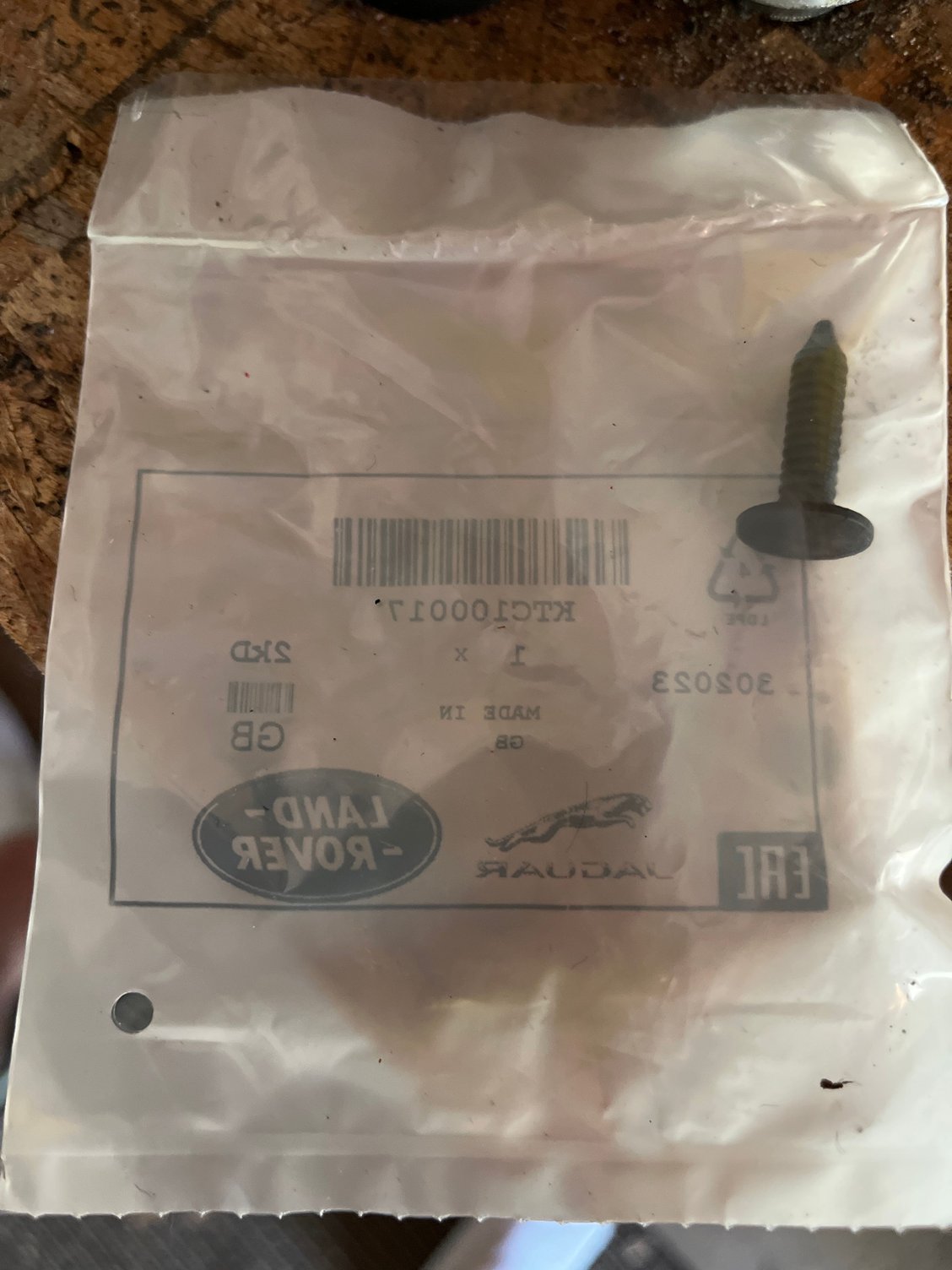

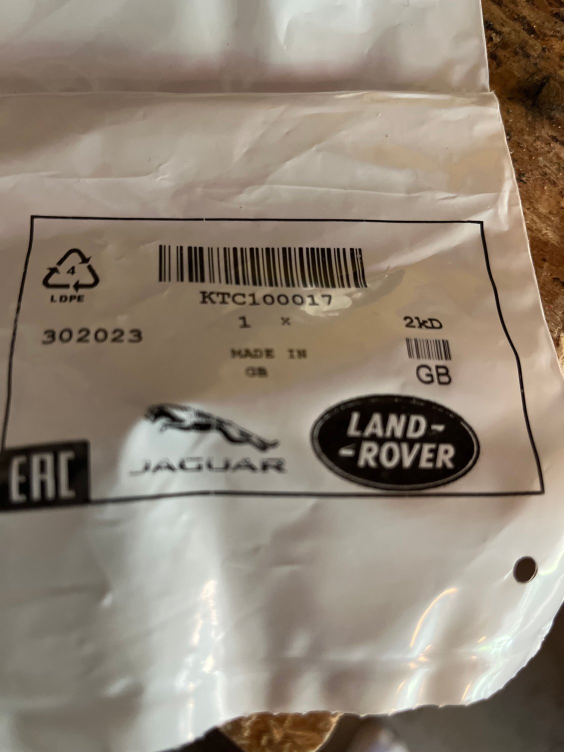

Got the part numbers and on order...
Door card pins & door bushings

Thanks so much for the pictures AND part numbers! Very well done.
