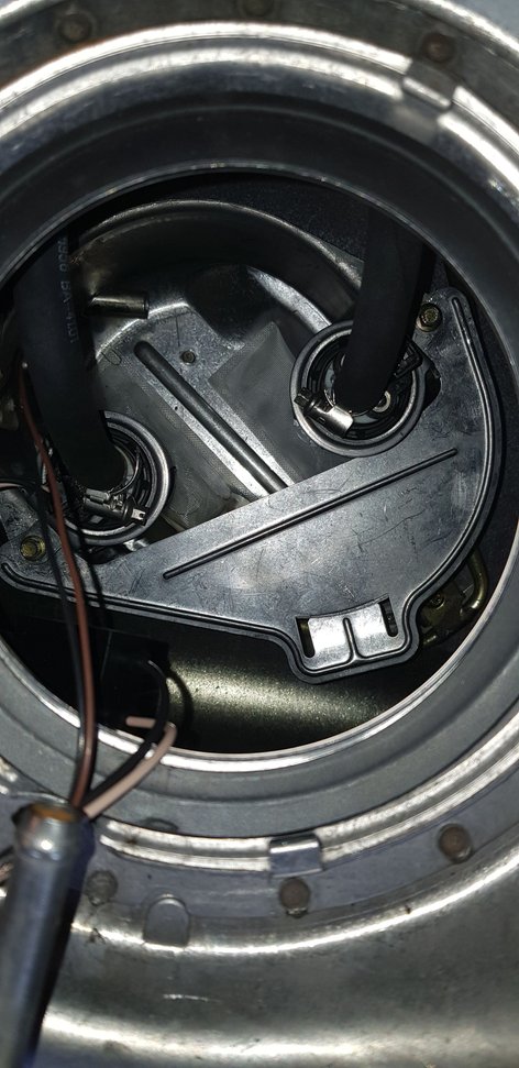

I did it!!
It took me all weekend but I replaced both fuelpumps and now the roar is back.

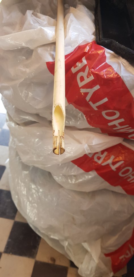

my two cents of advice is you need a friend with long skinny arms to get those fuel lines off and on again.
I shaped my own tool out of a plastic electrical pipe. used a small saw to shape it and then heated it with a heatgun and wraped the end around a 10mm drill bit. The long one made it
I shaped my own tool out of a plastic electrical pipe. used a small saw to shape it and then heated it with a heatgun and wraped the end around a 10mm drill bit. The long one made it "easy" to put it on the hose and push it into the connector. I could not get my big arms up to actually remove them so my neightbours kid had to help me with that.
If you have an XKR and swapping both pumps, just do one at the time. I unscrewed both at the same time and the splashguard fell off and was a pain to get back in the right possioton again. It is mounted with the same screws as the pumps. By just unscrewing one at the time the plate will stay put.
