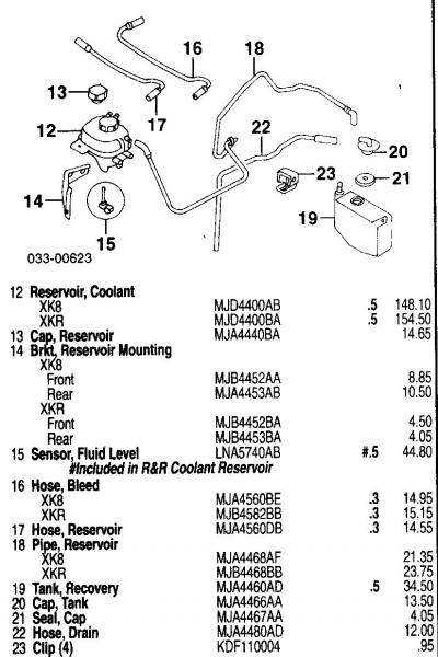

recently purchased 99 XK8 with 54K miles. had an alert today when turning, coolant fluid low or cooling system low? removed cap and it was a little low, had to add maybe 2 cups of water. seems to have fixed issue but noticed a coolant hose missing in engine compartment, unless this is for venting, pls see photo. any input appreciated, cannot find a good detailed diagram of cooling system showing all lines.
actually I did find a diagram that states there should be a bleeder hose there, but doesnt show where it connects at the other end?
there is an unused tube at the top of the radiator on drivers side, looks as if it may go there but need to be sure..

I've read that it's there as a potential backup connection if the first one breaks off (it is Jaguar plastic, after all).

My 97 XK8 originally had both hoses connected. The forward hose connected to the top left side of the radiator & is called the reservoir hose (see #17 in attached pic). The other connected where yours connects at the top of the engine and is the bleed hose (see #16 in the attached pic). Coolant flowed through both hoses.
When I had to replace the original coolant reservoir because it cracked, the replacement only had one functioning connection as yours does (the forward one). I was told to use it for the bleed hose leading to the top of the engine & attach the closed off connection to the hose leading to the top of the radiator, rendering it useless but closing the system.
Perhaps the later radiators don't even have the connection at the top left, I don't know.
