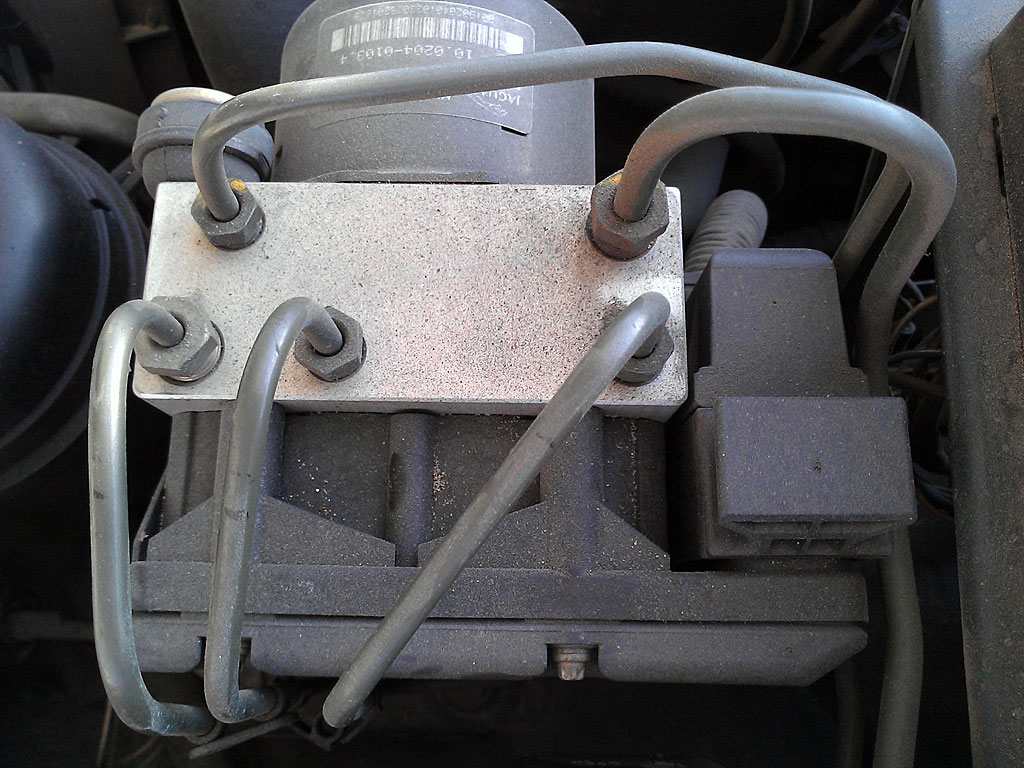

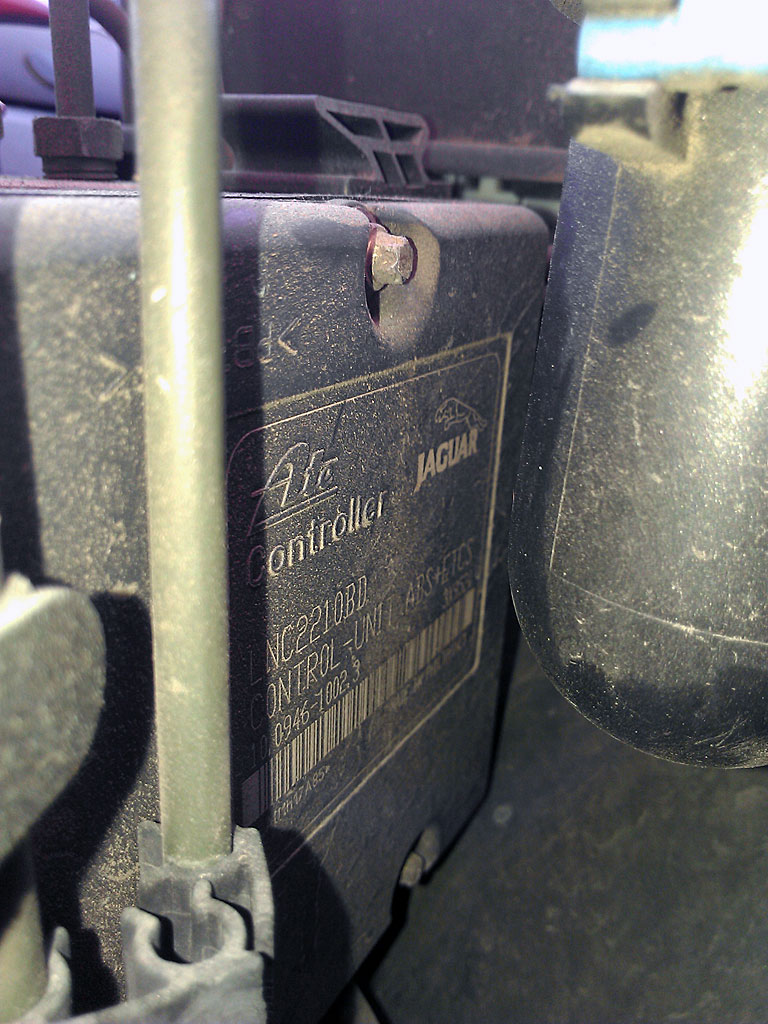

I was driving with Traction Control Fail and Low Brake Fluid Warning (unwarranted mind you ) for quite a while, but slowly getting tired of it. It stayed off most of the time during the winter (if you could call it that in AZ), but as it warms up it's back on regular basis again. I cannot live without my Jag hence I don't want to be sending my module for repair while waiting. I decided to purchase one from eBay. However, I'd be delighted if someone could confirm the compatibility with my car. I snapped some pics to show the installed P/N (LNC2210BD w/traction control), and will provide them below along with the link to eBay auction with module I am looking to buy .
As usually, any feedback on this is greatly appreciated.
Best,
Danny.
Clicking HERE will redirect you to eBay
Attached Thumbnails Correct ABS module for my 1999 XK8-abspartnum.jpg   Correct ABS module for my 1999 XK8-abstop.jpg

There is NO NEED to disconnect the hydraulic lines to renew the module. Just bend the lines to gain access to the mount fasteners and bend them back in place.
You will need a 5 pipe (6 valve JLM20555) from X308 or X100.
The LNC number means absolutely NOTHING as far as Jag numbers are concerned.
Check the VCATS label in the boot.
