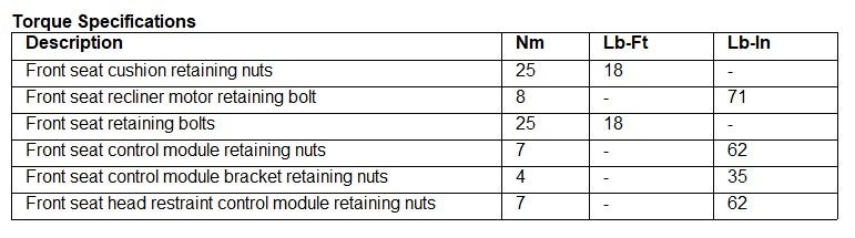

Hi All,
I couldn't find the correct torque call out for the seat anchors (4 bolts that attach to the body).
I thought I read somewhere that they should be torqued to around 25Nm. Can someone confirm?
Thanks for your help!!
Old Sep 28, 2020 | 08:51 AM
Likes: 17,006
JTIS can confirm:
