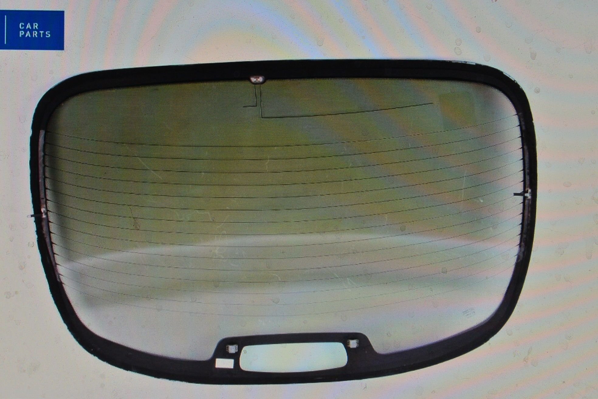

Found a screen on ebay with a good photo showing the connections so will try to access them with a couple of credit card sized metal plates to check for continuity as if it bust no point proceeding ..
Tags to left and right about half way up
