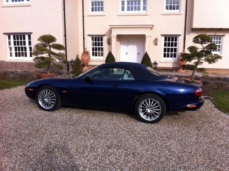

Old Feb 4, 2013 | 10:39 AM
Brihawk's Avatar
Posts: 34
From: Uk
Very happy with these (not chrome just a sunny day)
Attached Thumbnails Coventry Hornet 18X8.5 5-120.65 OFFSET question?-xk%2520whitley.jpg
Old Feb 4, 2013 | 03:03 PM
dannyS's Avatar
Posts: 217
Likes: 30
From: San Diego, CA
Default Need help in regard to correct offset for 18" Coventry Hornets O.O
Hello gents.
Beautiful wheels, Brihawk! . The car gains totally new, noble character to it...
