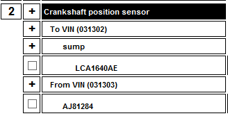

FWIW, here's the parts catalogue take:
LCA1640AE is the one with the connector on a flylead.
VIN 031303 was the intro of the AJ27 motor
